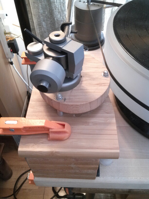

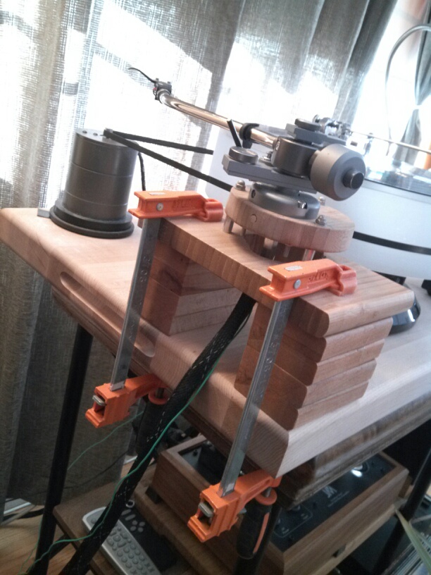

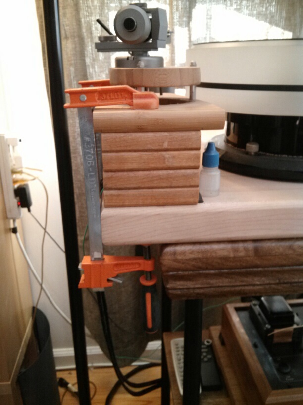

Not fancy or elegant, certainly not pretty, but does the job very well.  Slapped together with no regard for isolation or resonance control -- just made it sturdy and solid.  When I tap on anything (plinth, record, arm board / mount, shelf, rack, etc)  with the needle on groove / platter not spinning almost no "thunk" whatsoever comes out of speakers.   When  I do the same using the table's arm mounting system, a much louder "thunk" emerges.  So vibration control of my DIY mount is VG.
Fairly simple and easy......
I bought a cheap bamboo cutting board, cut some blocks, stacked them, and clamped the top platform tightly onto a butcher block that slightly overhangs edge of top shelf.   I also cut the round top mounting plate.  Platform height is roughly adjusted by varying the number of blocks.   Plate height is fine tuned with various length aluminum spacers.
I have several arms so I made a plate for each.   I leave the plates attached to the arms for simple and quick swaps.  I made the plates same dimension as the stock acrylic one that came with the table (Scheu / Eurolab Premier Mk2).  In this way I can easily also use the arm in the traditional back right corner, if desired.
The advantage of this method is that the arm position is really locked in.   So long as the table is heavy and solid and doesn't move easily, then the mount distance is never lost.  Same can't be said for stand alone pods as they can be inadvertently moved.
Also, when lifting entire butcher block to relocate the table the position of this mount relative to table is less likely to shift,  again maintaining mount distance.
The visual could be improved by attaching the mount  (bolt or glue?) onto the butcher block, but I wanted to maintain flexibility in arm location.
Only simple hand tools were used: circular saw, jigsaw, drill, belt sander.

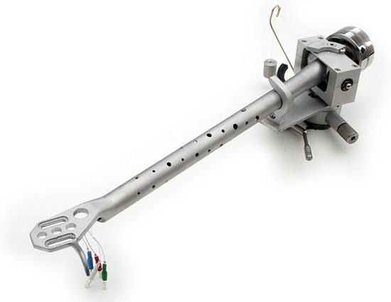

I've been drooling over the Audiomods series 5/Classis-2 tonearms for my JVC QL-7 rebuild.
It's available completely built or as a DIY kit and with different plating options.
To me, it looks great and the price seems very good but I'm not a tonearm guru.
In fact, this would be my first after market arm if I decide to buy it.  HELP.
It looks like the same arm as mentioned earlier in the AC thread below, except that arm has the optional micrometer for VTA adjustment.
https://www.audiocircle.com/index.php?topic=93000.msg924849#msg924849
Here's the link(s) for Audiomods, either completely built or in kit form.
http://www.audiomods.co.uk/completearms.html
http://www.audiomods.co.uk/armkits.html
The only thing I'm wondering about is if the Audiomod arms are adjustable azimuth. VTA, yes.
Maybe Ericus Rex will chime in and give us his opinion of the Audiomod arm.

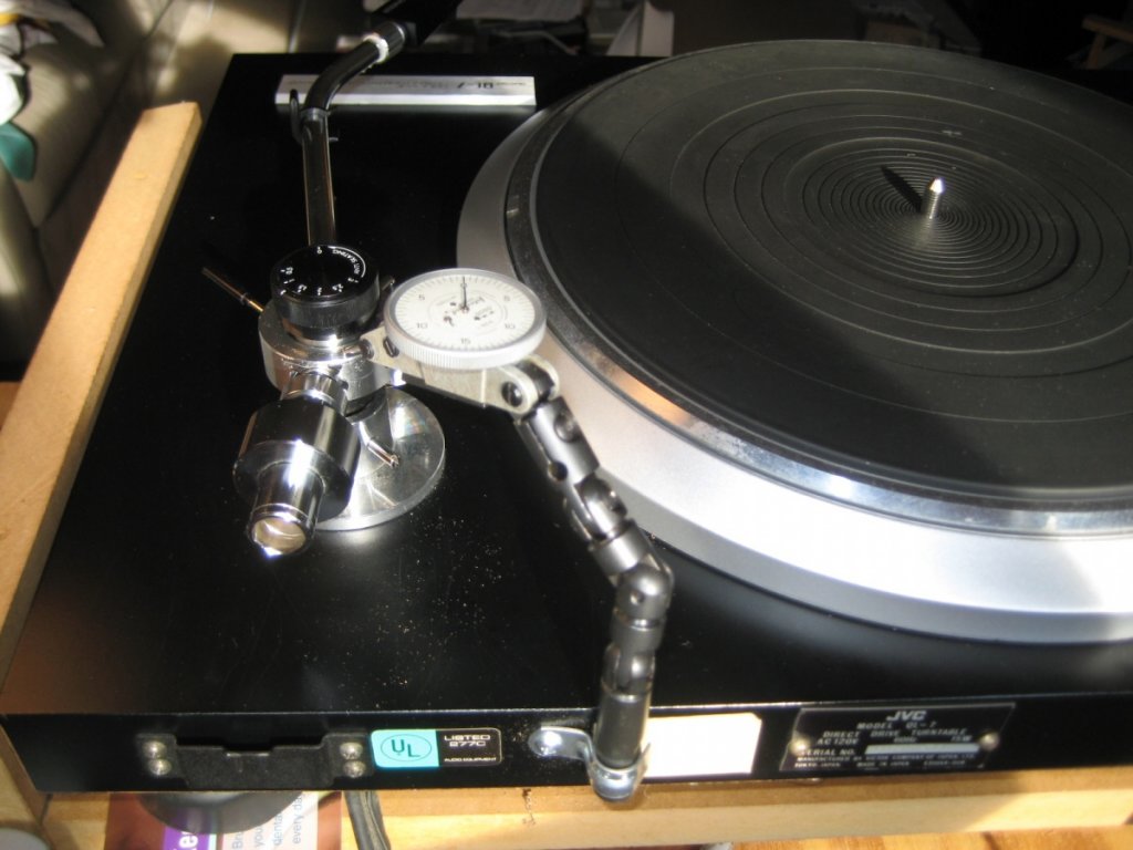

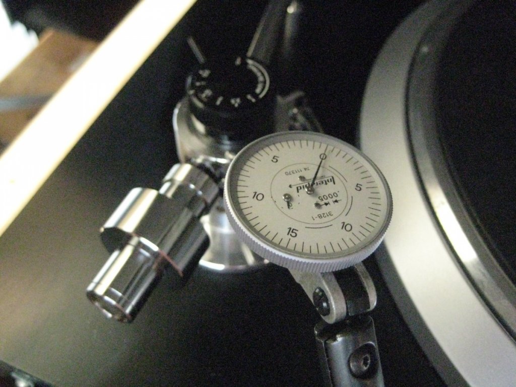

The picture below shows what I do to adjust VTA on my arm. I use my dial indicator instead of a micrometer. Works great for me.
Since I use my indicator, I would get the Audiomods arm with optional ceramic bearings and void the micrometer expense.

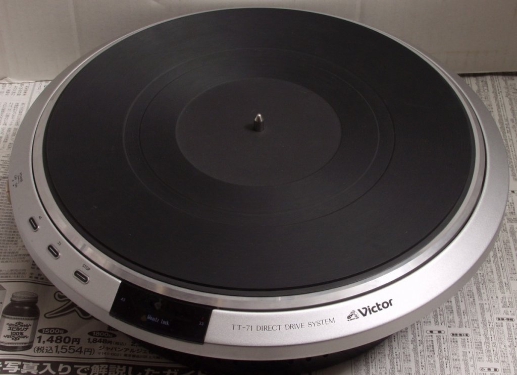

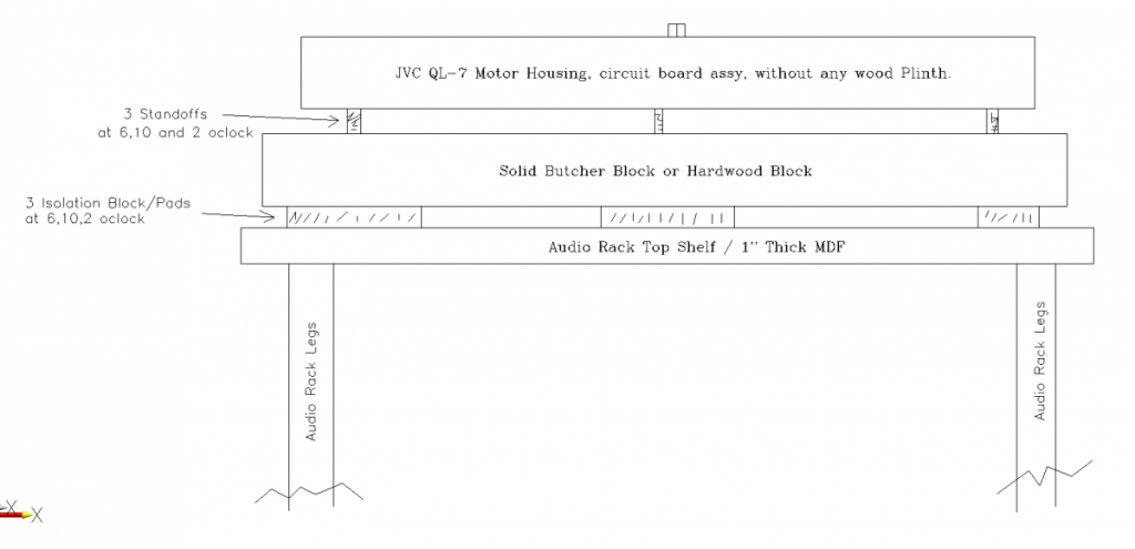

Below is my JVC DD motor housing and circuit board. I've been thinking about building a heavy duty massive new plinth out of exotic wood, or a thick
piece of granite plate machined on a Waterjet for the motor housing and NEW tonearm holes but why go thru all that trouble.
Why not skip the noisy wood plinth and just set the JVC motor and circuit board housing on 3 solid standoff's mounted to something like a butcher block
which has isolation blocks/pads underneath?
Add the tonearm similar to what Sunnydaze has done.
Here's a quick drawing of what I'm talking about and a couple examples. Nothing is set in stone.
