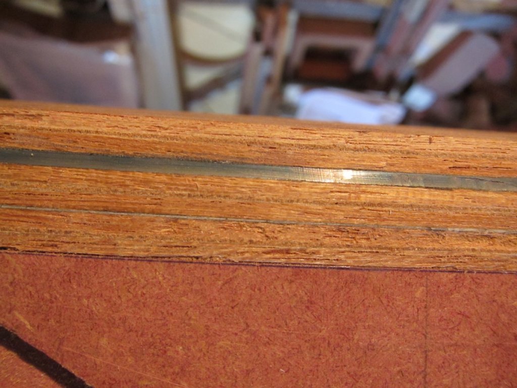

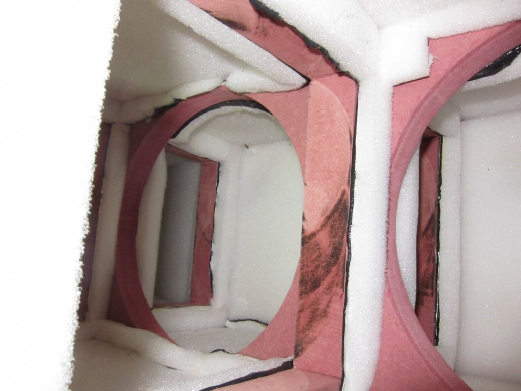

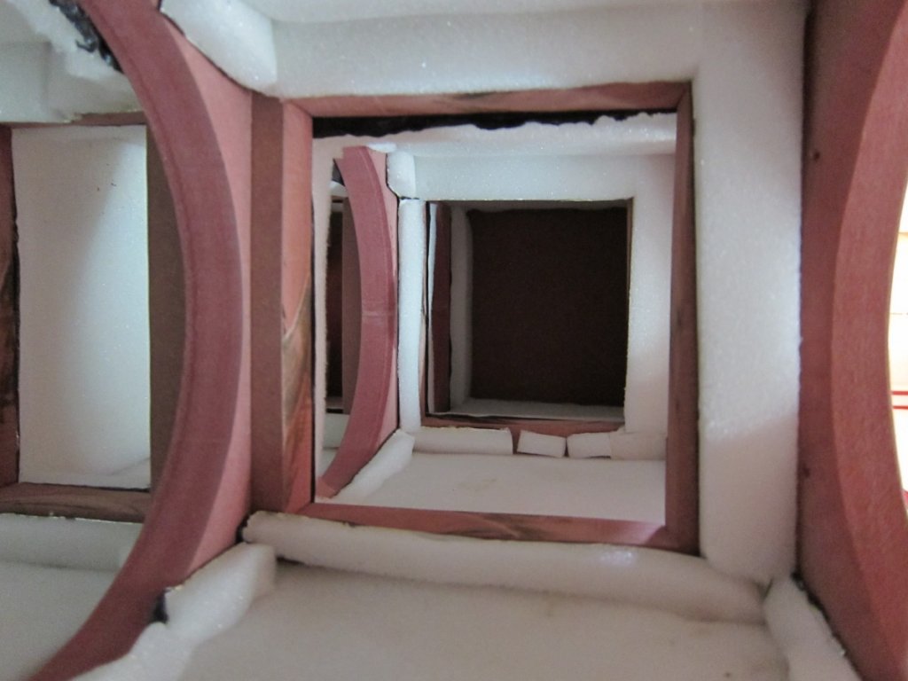

Bob, you are right it is thinner layers of ply bent around an arc. If you look closely at the first picture of the Tempesta you will see a pattern in the top left corner behind the speaker (covered in plastic sheet). I used this pattern to bend layers of 6mm ply to the shape. This is not my first pair of bent sides speakers. I have used the same pattern for some of my earlier speakers.
The wall thickness includes 3 layers of 6mm ply, 1 layer of 3mm resin bonded fiberglass and 1 layer of 3mm lead sheet so yes the total thickness is about 24mm. Once I add 4mm of veneer to the sides it would be about 28mm. BTW because we live in Mumbai, India (think hot and humid) all ply and veneer we use is capable of surviving this climate.
For the outer layer of ply I prefer to use a better quality of ply so as to get the best possible finish.

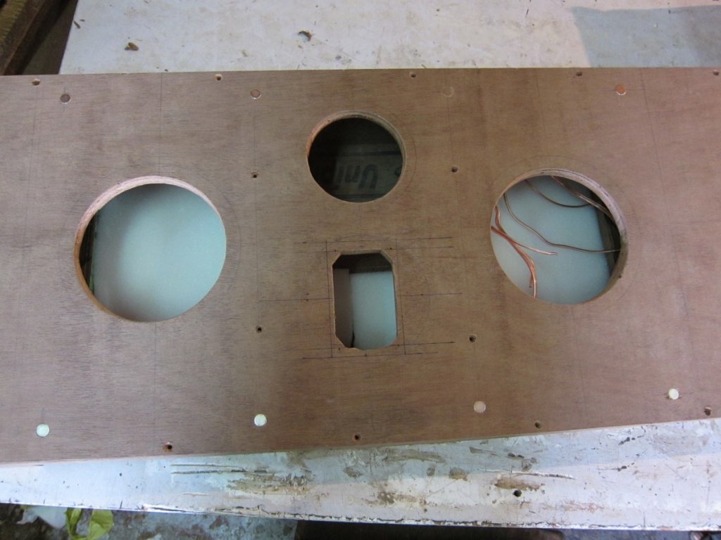

To attach the grill I embed small 10mm dia x 6mm thick NdFeB in the baffle. The grill then has a matching steel plate at that location. I have attached some pictures of the center speaker
You can see the NdFeB magnets in this close up

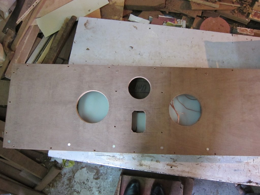

This is the full front view, the speaker is 48" wide, 16" high and tapered from 4-6" in depth (including veneer thickness).

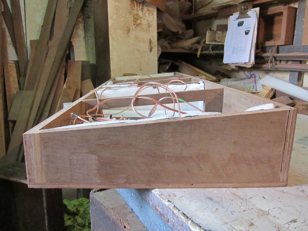

side view of speaker showing taper

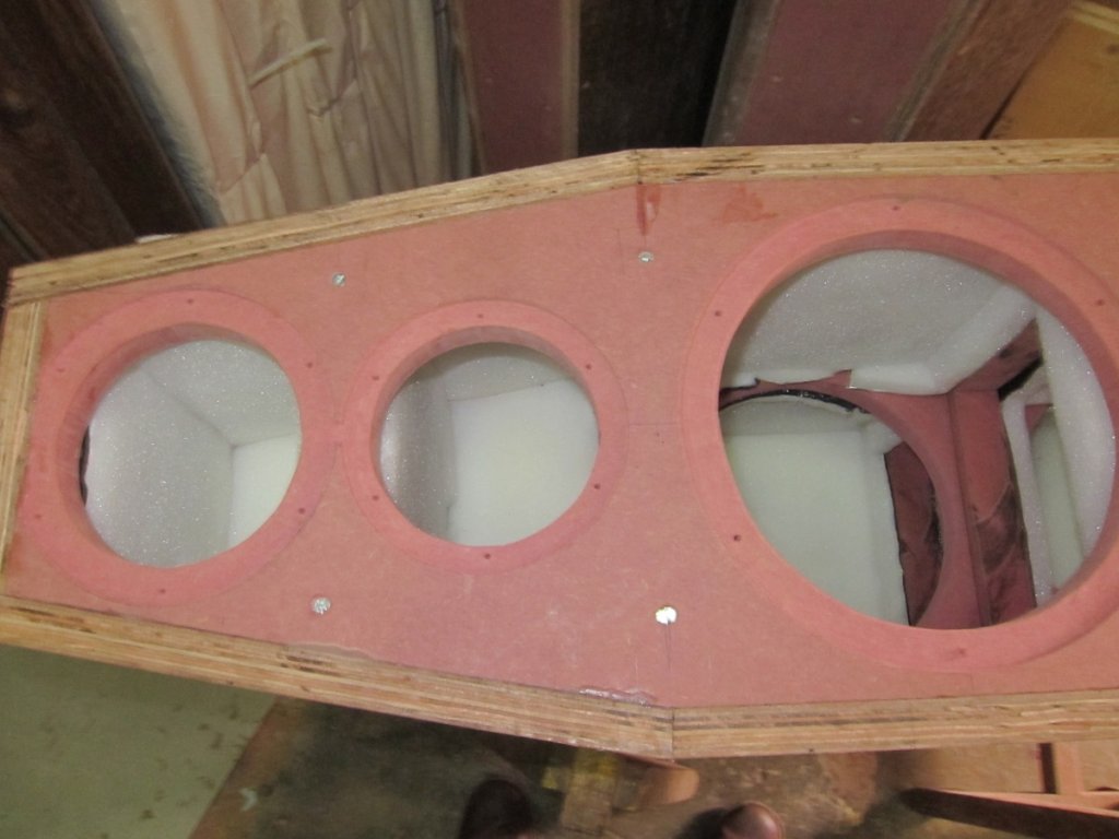

Close up right woofer, mid and tweeter cavity - that little hump you see on the bottom left is a depression made to accomodate some wall deviation against which the speaker will be kept.

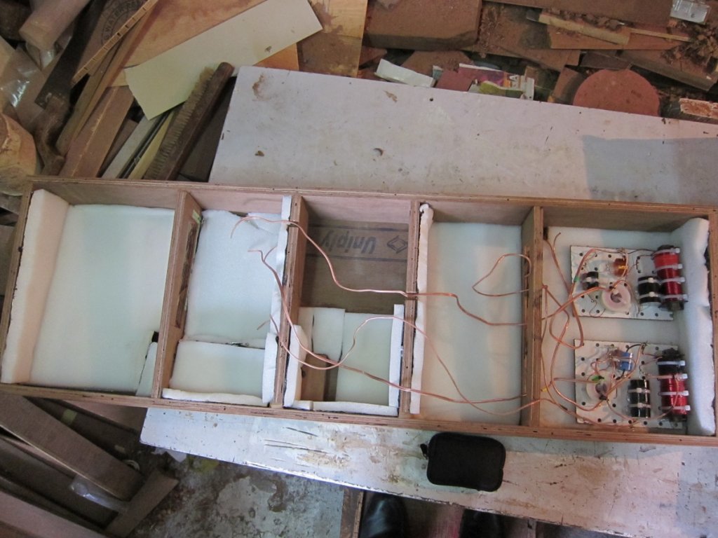

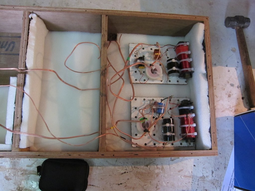

Close up of woofer, mid and tweeter crossovers. Woofer and tweeter share a board.

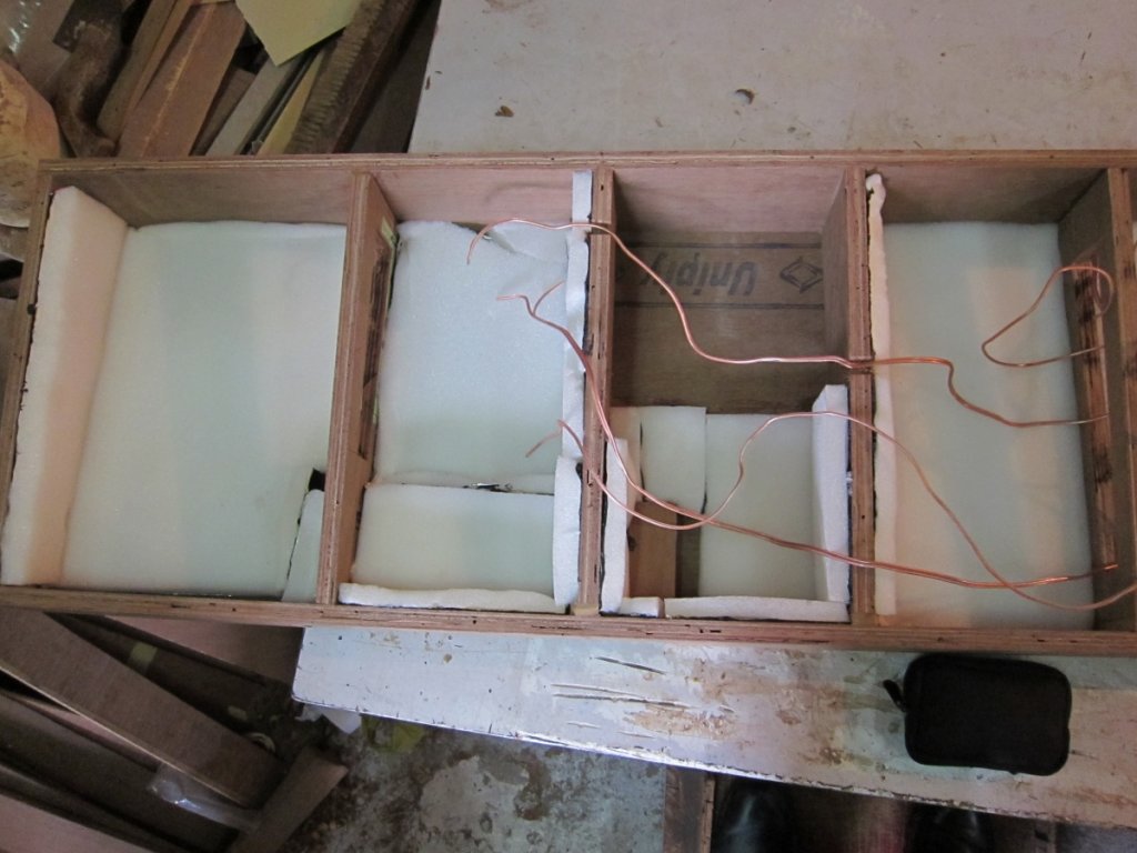

View of center speaker without front baffle (pre veneer, polish, etc..).

Bob this picture is for you...it shows 3mm Lead sheet and 3mm resin bonded fiberglass layered between 3 layers of 6mm marine grade ply. That is the cross section of the Tempesta side walls. oh and BTW I do NOT think using lead in a canoe's side wall will help.  :lol:

Very cool Navin, thank you for the photo. I'd love to give a tap on that side panel, I'll bet that's as dead as a hundred year old oak tree!
