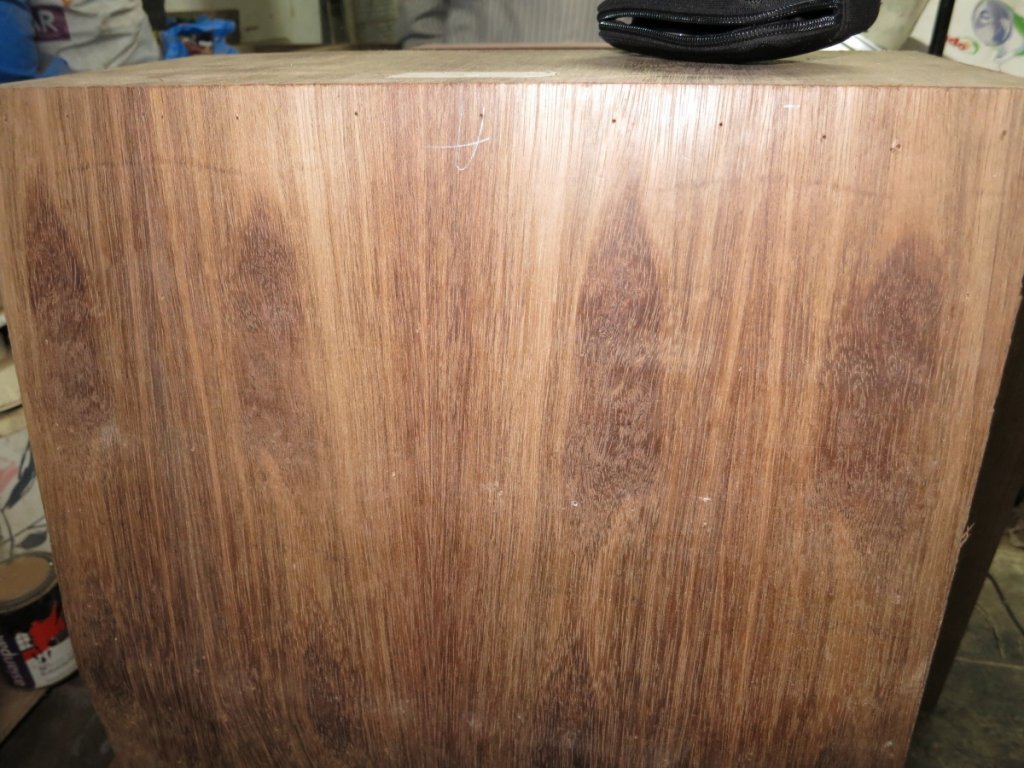

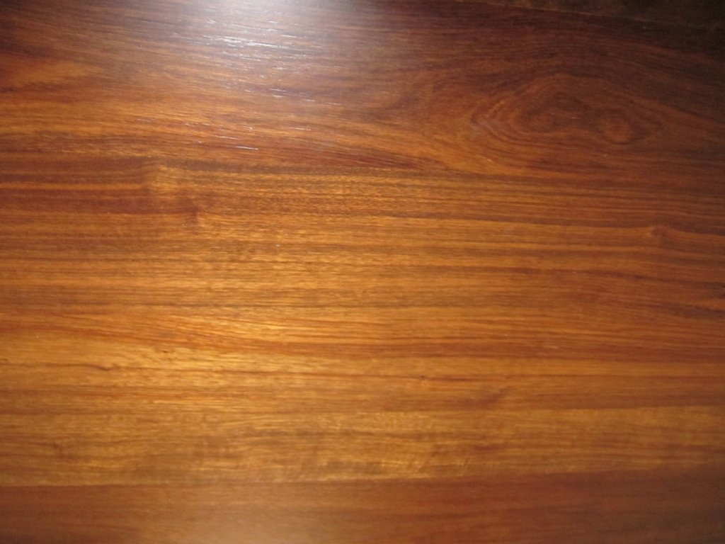

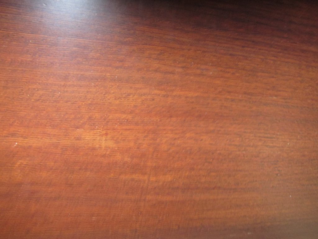

Veneer being used for the Tempesta Extreme. In real life the veneer looks a lot richer. My P&S cant capture this.
Veneer used for RC4 and center channel.

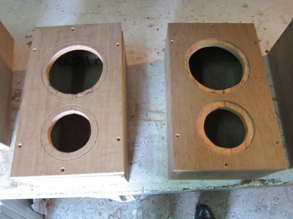

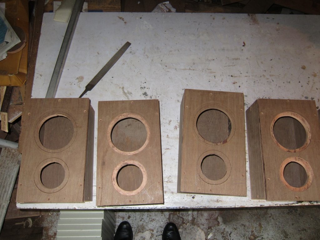

2 pairs of rear speakers to go with the RC4

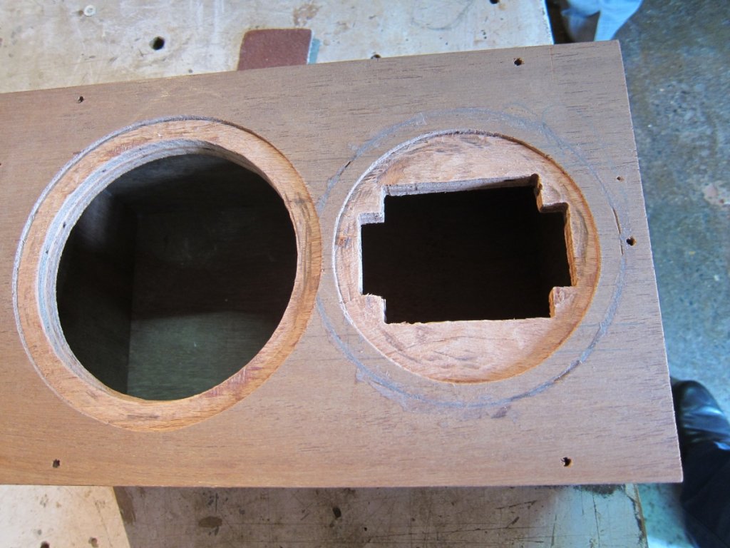

Close up of single pair of rear speakers used with RC4. Routing for drivers on one speaker not done.

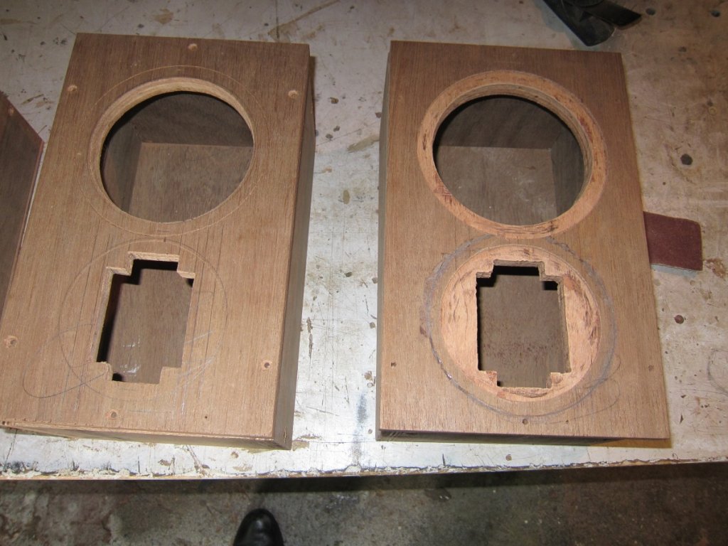

Rear speaker to be used with Tempesta. Again one speaker has been rounted and the other has not to show the difference.
Close up of rear speaker to be used with Tempesta.

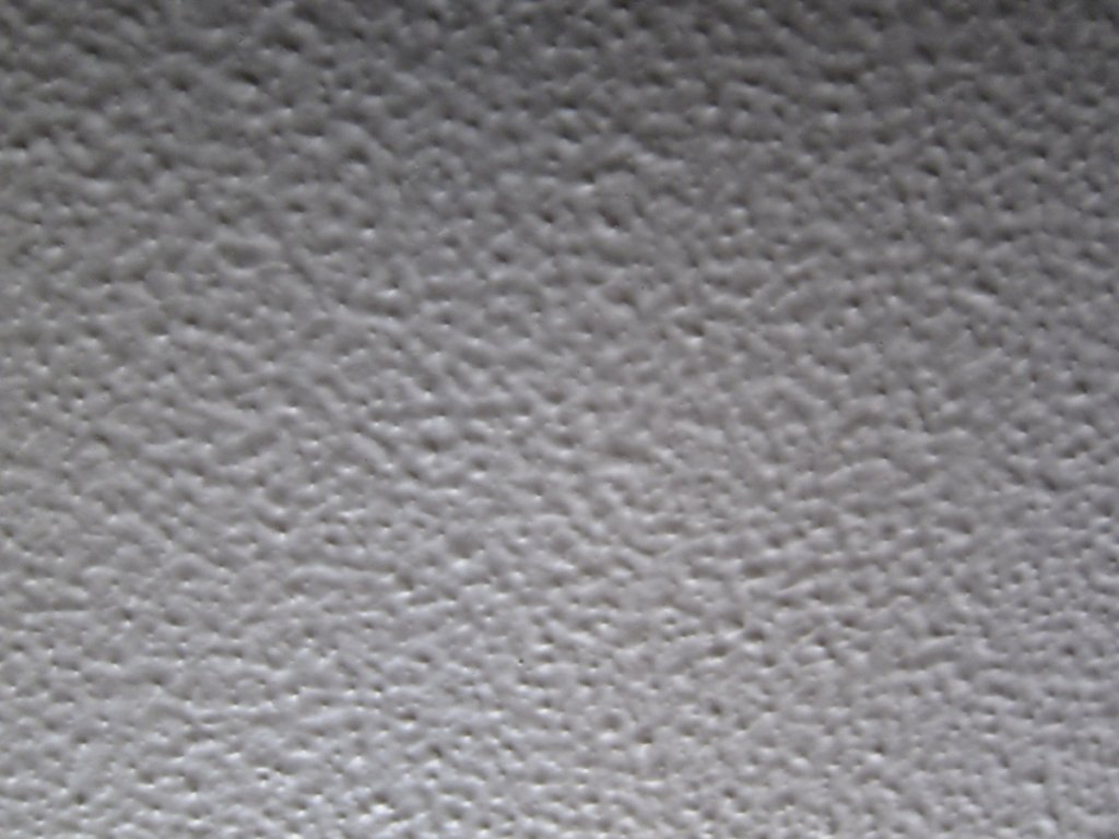

Paint finish for rear speakers. I hope you guys can see the texture.
Next stage after routing is to install magnets for grills, damping, and crossovers. Then they will be painted.

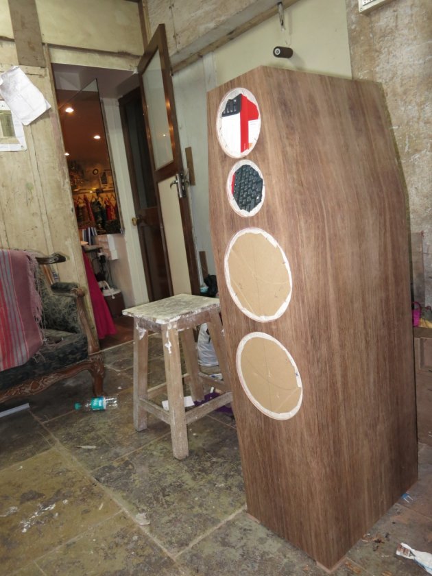

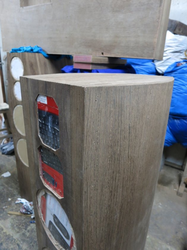

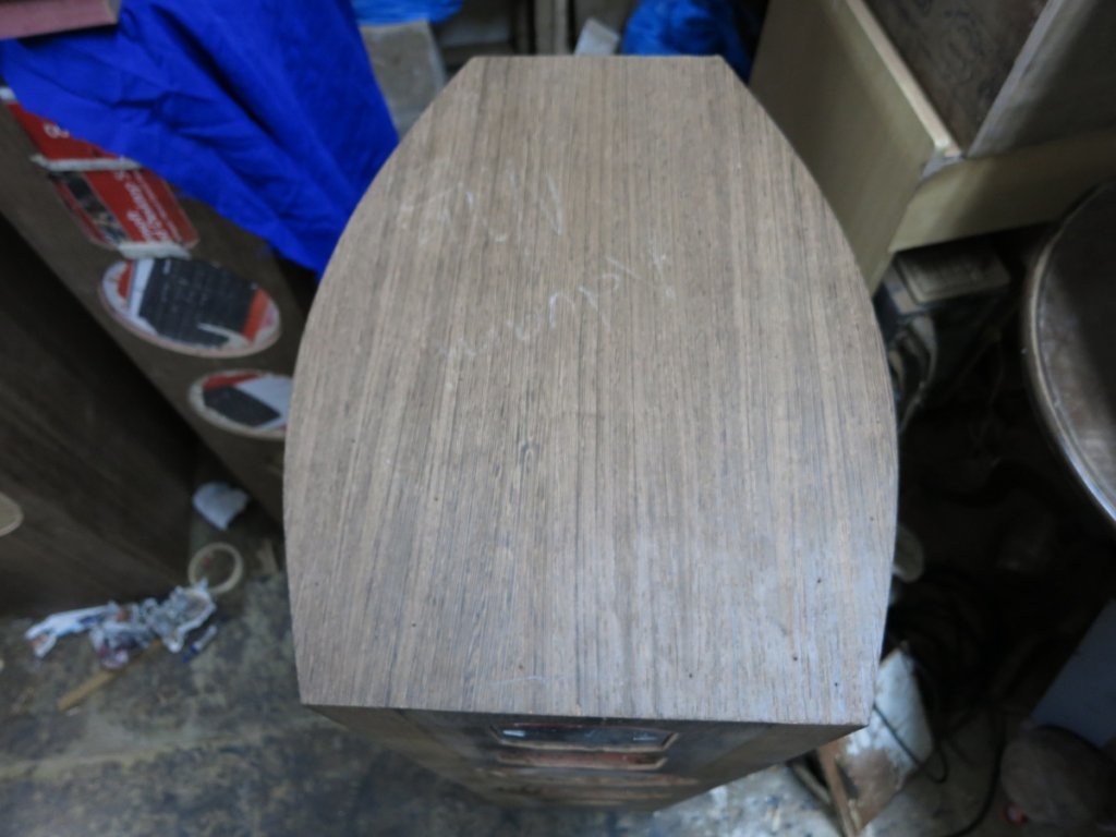

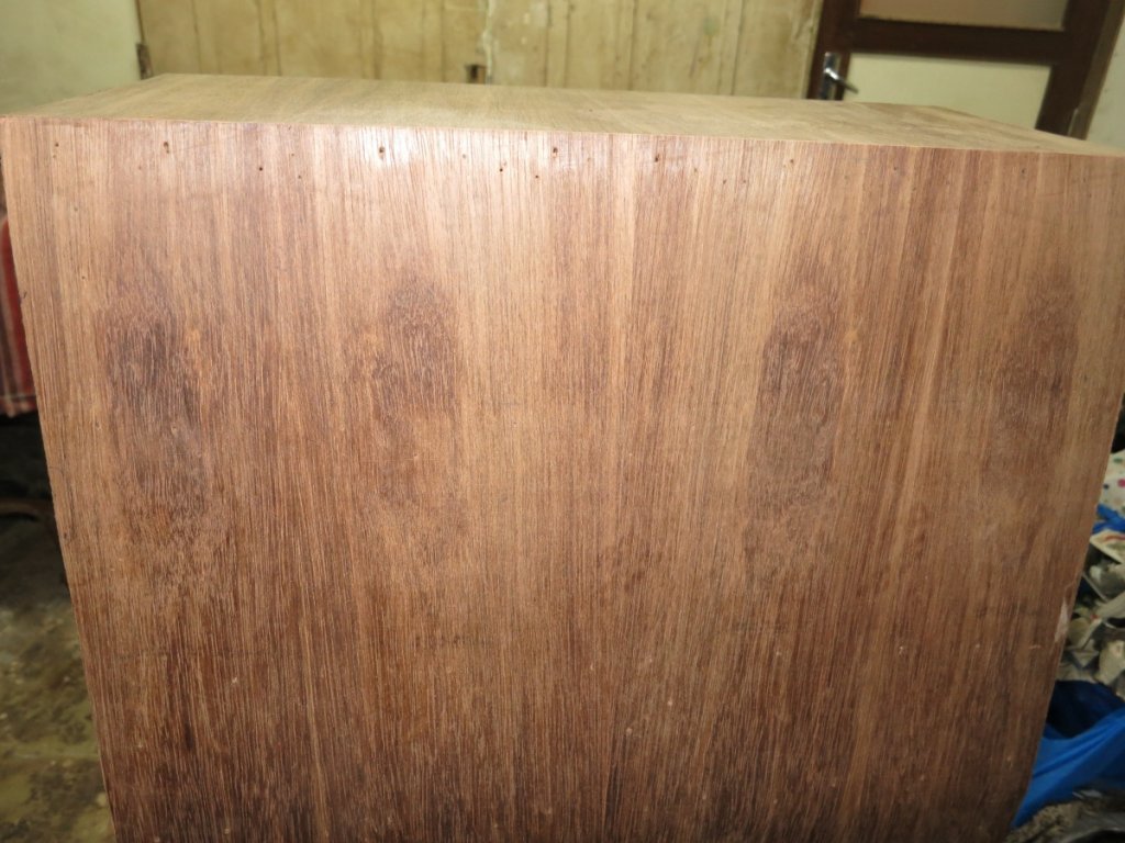

Songs from the wood make you feel much better (Ian Andersen). Speakers before they are sent for polish.

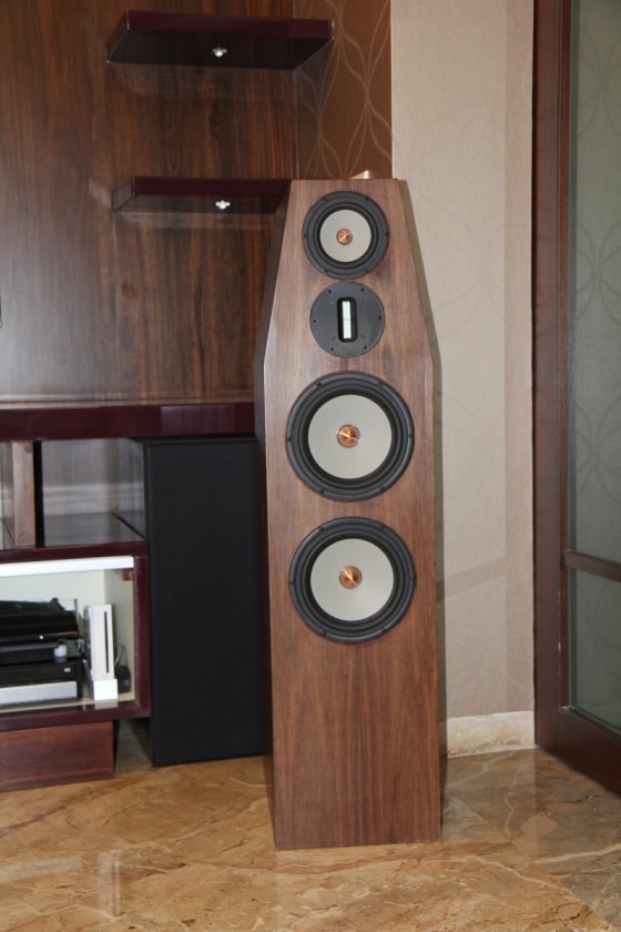

sub-less RC4 in Braziallian walnut

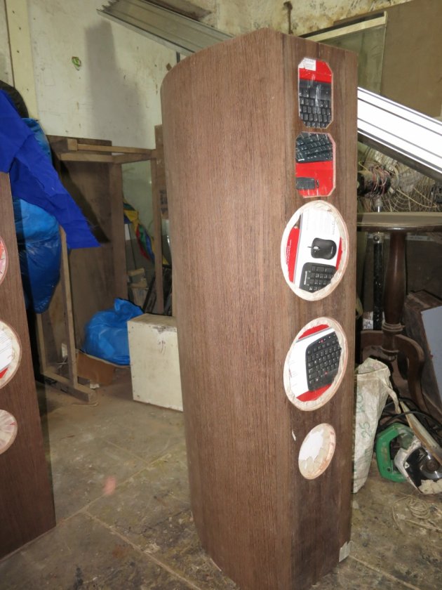

Tempesta Extreme in Wenge
Side view of top of RC4 (the eyes in the veneer are matched left to right)
Side view of top of RC4 (the eyes in the veneer are matched right toleft)

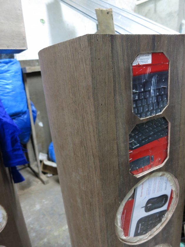

Top half of Tempesta Extreme. Driver holes are covered so that the crossovers and open cell foam are protected from the polish
Top view of tempesta extreme (you can see the curved profile of the sides)

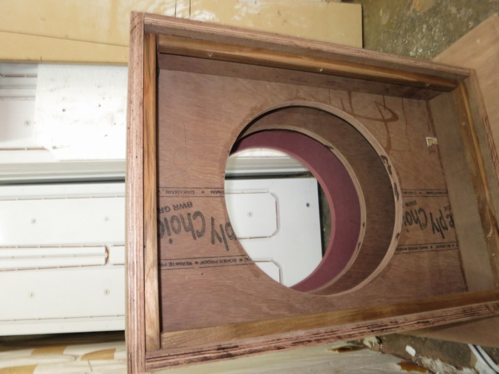

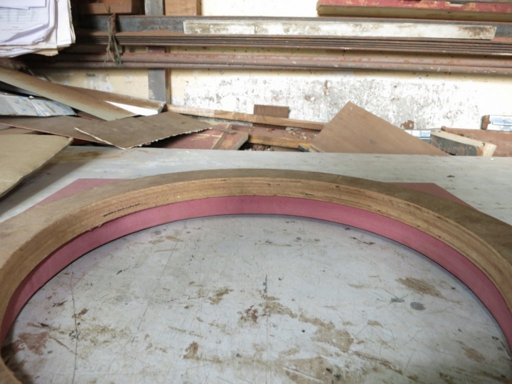

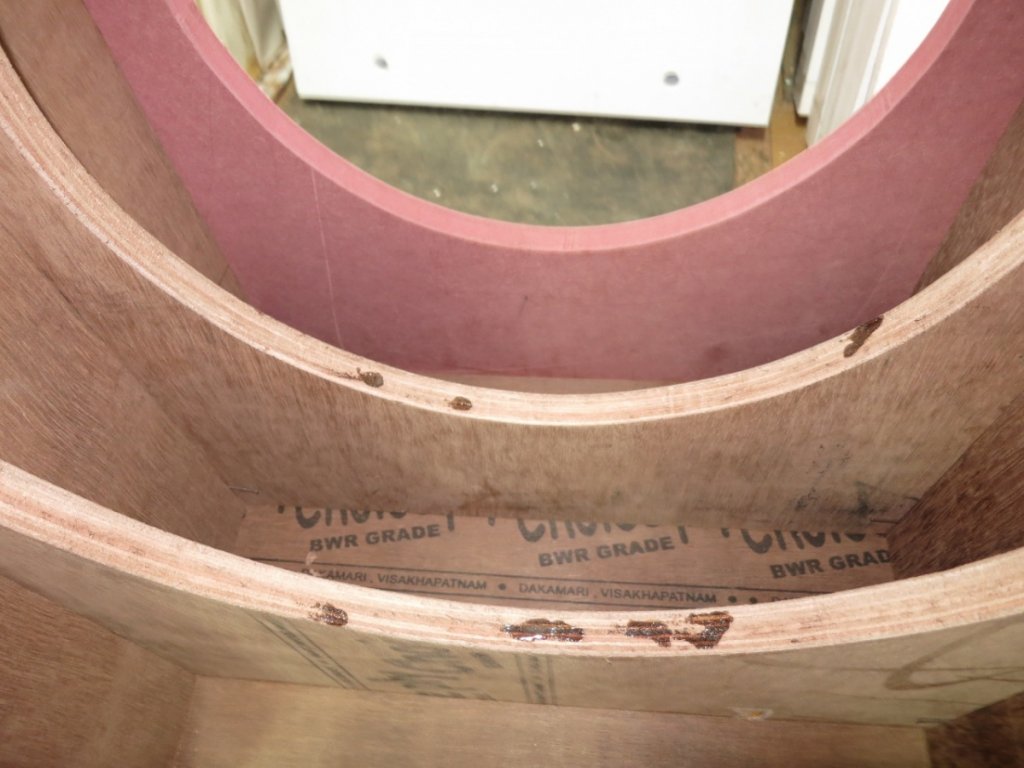

After I paid the Arcam and Onkyo dealers I and asked for delivery they told me they had no stock and delivery would take 2 weeks or so. So here I was with not much to do so I decided to build the subwoofers (a 3 cu. ft. box with the TC15 and a 2 cu. ft. box with the TC12). Each subwoofer will be driven by a Yung SD500 plate amp.
Subwoofer baffle has a ring behind it for the extra long screws.
TC15 box without baffle. The baffle is a combination of 25mm MDF 3mm of fiberglass and 25mm of Marine grade ply and will be added next week.

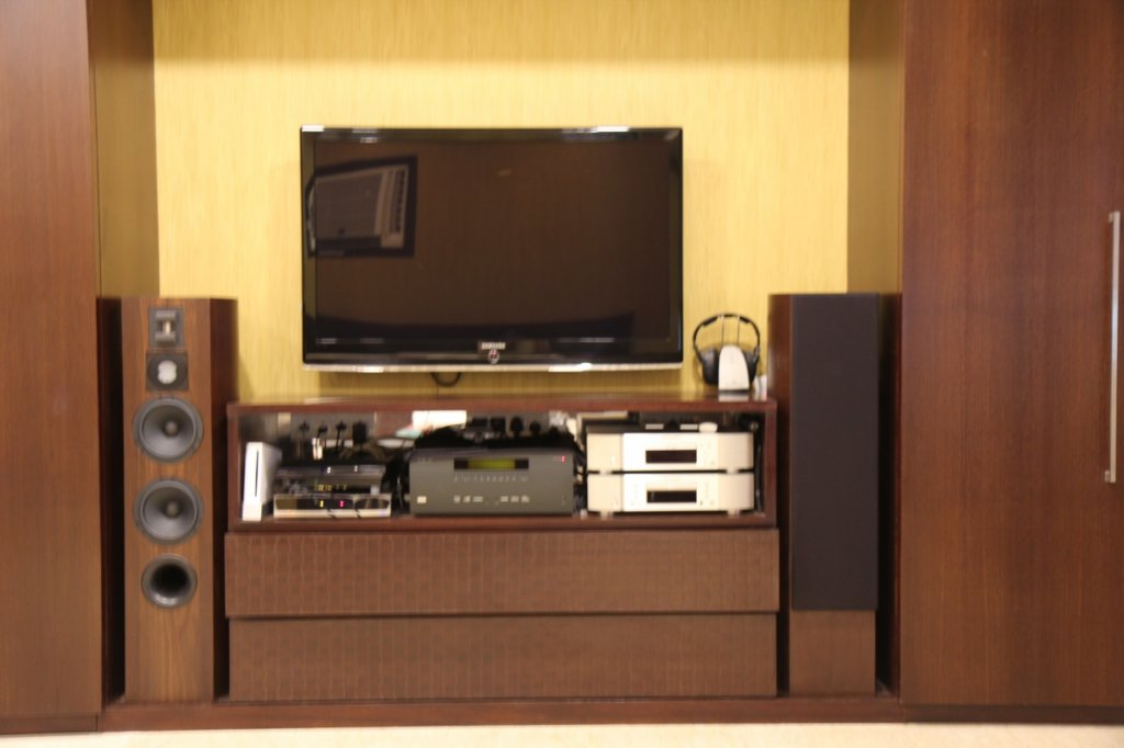

navin

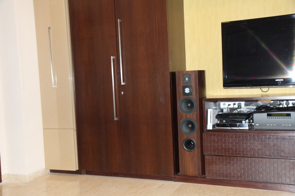

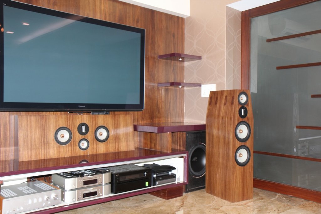

Living room system
Peridot Excel
System

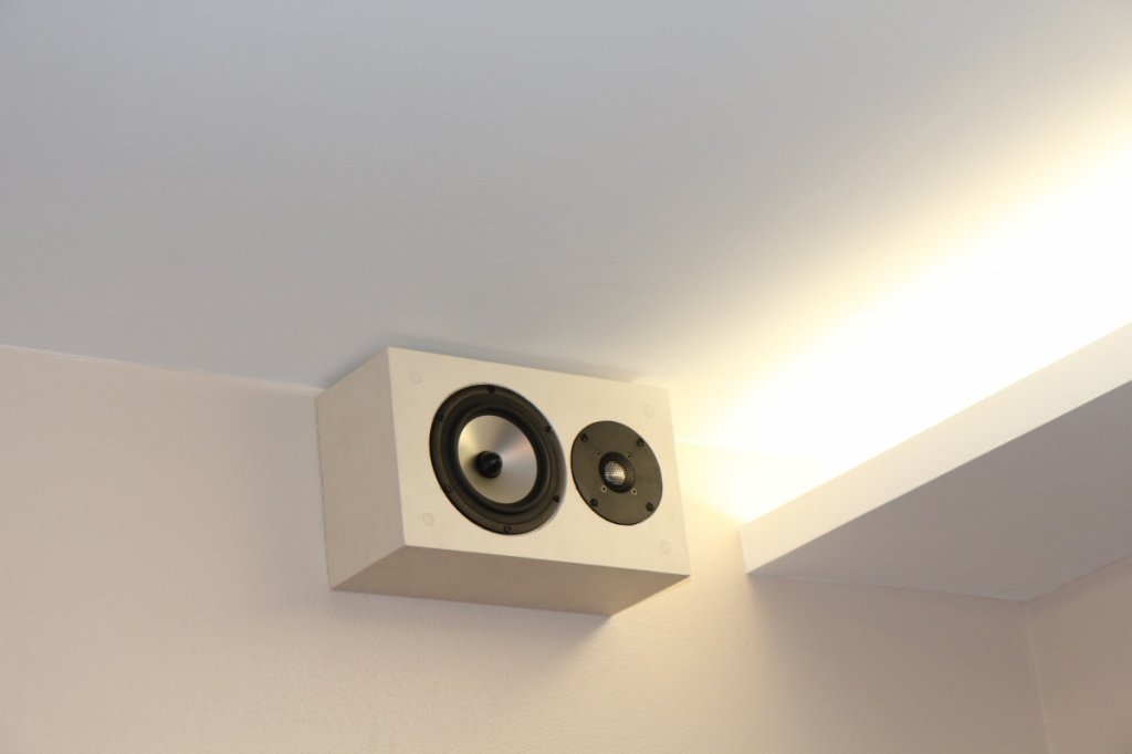

Rear for Peridot Excel
Bedroom System

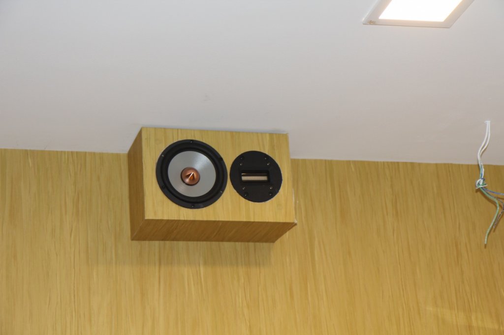

Tempesta Extreme
Wall mounted S6 as rear for Tempesta Extreme

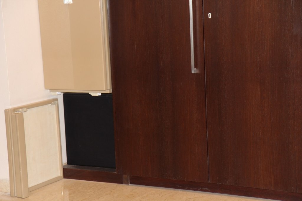

Subwoofer closed
Subwoofer open (I have to add a hinge to the door).
