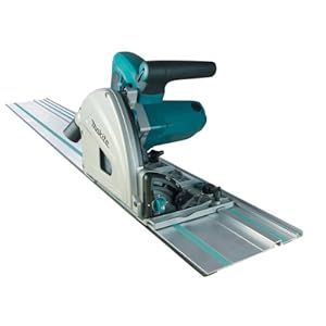

BTW here's a new toy I just purchased that makes cutting large sheet goods a breeze.
http://www.amazon.com/Makita-SP6000K1-2-Inch-Plunge-Circular/dp/B000UYTKG6/ref=pd_ys_sf_s_228013_a1_6_p
I found a reconditioned unit and saved a hundred bucks. It looks and works like new.
