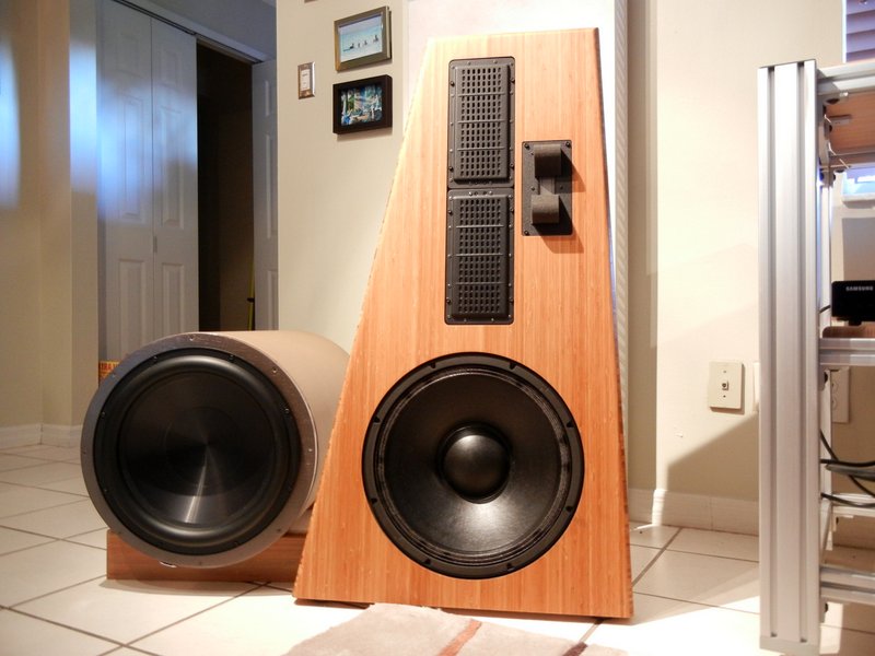

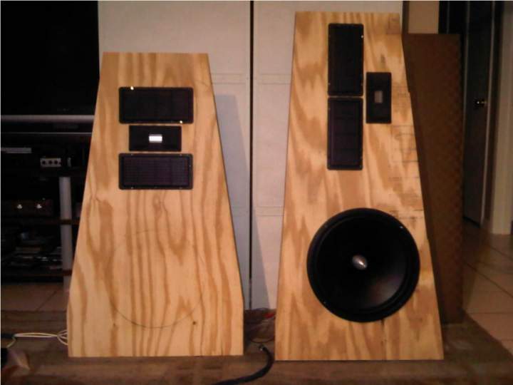

Steve, I ran Maggie MMGs with open baffle woofers that I created for nearly 5 years.  One developed the dreaded conductor lamination and I swung back to the DIY side of things.  I loved them, but they are so low sensitivity, that even with a monster amp like a Krell KSA-250 I had here for a while, you lose some dymanics.  The BG drivers also have the upper hand in that they have double sided magnets, which lowers distortion and creates a push-pull action which allows more "jump" factor when you really get the SPL up there.
BG planars are really wonderful drivers when used correctly and properly filtered.  Open baffle, they all tend to have a rising response which is not a problem as long as you can create create a crossover, or in my case turn some knobs on some DSP to correct for it.  I have more direct experience with the smaller drivers of the Neo series, like Neo3, 8 and most recently Neo10 than the RD75, but the RD have always sounded excellent when I've heard then in systems.
My own open baffles are using a pair of Neo10 per side.  These are running with Raal ribbon tweeters and a pro audio, high sensitivity woofer with Rythmik subs for below 60Hz.  Surrounds use a pair of the Neo8 for mids and highs.  Not the best thing to do, but for how often I use surround, they are OK.
I also am developing a new studio monitor for one of the engineers at our studio that uses the newest Neo8-S and a smaller Raal for mids and highs.  The resolution and micro-dynamics of this thing is crazy!  And it's not that tipped up top-end, false type of detail either.
Outside of my own creations, you are going to start seeing more and more designs using the Neo10 pop up this year.  They only became available for OEM and DIY use about 2 years ago and it usually takes that long for manufacturer to release new product.  Danny over at the GR Research circle has a whole line of speakers(undwer the Serenity Acoustics name) based on the Neo10/Neo3 combo, Dennis Murphy from the Salk circle uses the Neo8 in his Carnegie line of speakers and Dan Neubec over at the Parts Express forum made a great 3 way system using the Neo10.  Both Danny and myself feel that the Neo10 is the best midrange driver we have ever heard.  I bought about a dozen different drivers when prototyping my open baffles and the Neo10 won hands down over any other driver I tried.

I'm curious if you tried an mtm configuration on your ob with the neo10 and raal? Just seems intuitive that having them in a line would be a good thing....
studiotech
Re: Bohlander Grabner or ESL
« Reply #11 on: 21 Oct 2012, 04:14 pm »
A traditional MTM arrangement would have put the Neo10 rather farther apart than they should be since the Raal is so tall.  It's all about center to center distance and xover frequency for proper blending of an MTM.  I did try an odd solution by putting them all horizontal and stacking them up MTM, but preferred the side-by-side layout.
The Super 7 that Serenity is offering uses an MTM arrangement with the Neo10 on their sides, but with a Neo3 which is about 4 inches shorter than the Raal, so it may work well.  And Danny's crossing over to the Neo3 lower in frequency than the Raal is comfortable with.
