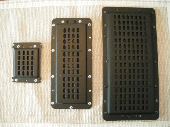

Regarding Neo8 and Neo10, data published by German Hobby HiFisay that Neo10 has about 5 times greater radiating surface than Neo8.
Regarding Neo8 and Neo10, data published by German Hobby HiFi say that Neo10 has about 5 times greater radiating surface than Neo8.

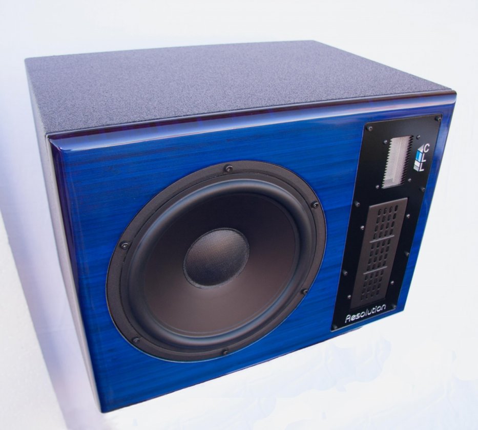

Hmm, Greg. I have an extra Neo-8 and a Raal ribbon sitting on a shelf in my storeroom. I'm wondering if they might be used in a configuration like yours. Would you be willing to share your plans?
Studiotech,Nice. Looks like an FPE panel to accommodate the RAAL tweeter and Neo midrange planar magnetic driver!Best,Anand.
