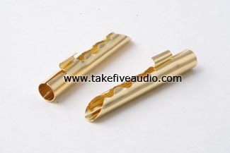

I use the BFA's "SRB" uses from Take 5 Audio, they are light and spring steel from Switzerland? Fit nicely and durable never had any problems. They have a feeling of confidence using them, these are soldered only. I don't care for the set screw types.
Although I do have some locking ones from DIY Cable when Kevin had them on sale and a set of the better Nakamichi types in reserve.

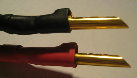

That's interesting to know. I bought mine direct.
There's nothing really wrong with them, considering the price, they work fine. I'd like to find something similar that is designed to be soldered.
John,
What wire are using in the photo?

John,
Larry
Hi Larry, it's CAT6 network cable.

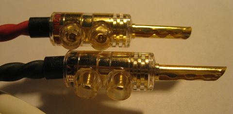

I didn't try to crimp the Multi-Contact LS4, but I have tried to crimp a Nordost Z-plug, which looks and feels exactly the same (and for all I know could be where Nordost sourced them from).  The material and/or heat treatment is too hard and the plug split and cracked.  I don't have any extra LS4s to try, but it would be interesting to know if someone was successfully able to crimp them.
I previously mentioned the ViaBlue TS2 bananas (not really C&C @ $6 ea.) which uses a gold-plated 100% soft copper crimp sleeve similar to the idea that lacro proposed about using copper tubing sleeves with the Nakamichi plugs.  I like and prefer the fact that the ViaBlue TS2 has easy-to-securely-tighten hex screws versus slotted or phillips, but I still have to question if soldering direct to the Multi-Contact LS4 (or equivalent) isn't at least as good (or better?) as a soldered or crimped sleeve that is then secured with screws.
ViaBlue TS2
