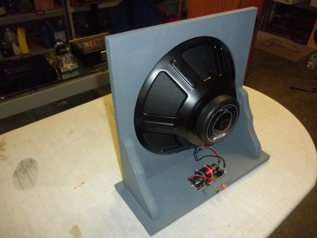

« Reply #4 on: 24 Sep 2012, 01:55 pm »
JohnR
Re: smallest H-Frame that can be made
« Reply #5 on: 24 Sep 2012, 03:31 pm »
 :green: :lol:
Very nice  :thumb:
No measurements tho.

« Reply #6 on: 24 Sep 2012, 03:37 pm »
i exactly thought the same...looks great wheres the measurement...

« Reply #7 on: 24 Sep 2012, 05:00 pm »
You really don't need measurements to confirm what you already know.  That's just a novelty project.....and a pretty neat one.
But the frequency wavelengths and cancellation distances don't support any (real) bass capability.
For a desktop environment, area must be a primary concern, no?  I don't understand why someone would consider an open-baffle project for this usage since it would take up much real estate.
Dave.
