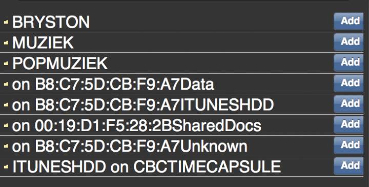

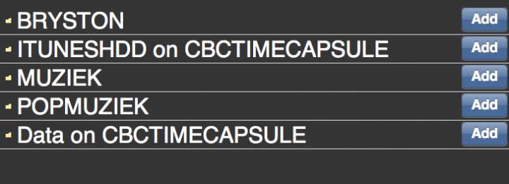

1 question for Chris: can I point MAX to a specific folder in the Nas drives? Now it points to their roots, and I have to click my way the music files/folders on that drive.
Marius
btw, the strange "on" listings have disappeared nicely, and now my drives in MAx look like this, just as they should:
 :thumb: :thumb:
 :thumb: :thumb:
I have the QNAP NAS at home an no issues with 192/24 and the Apple Time Capsule at work and no problem.
The 'strange' listing will disappear once all is loaded usually.
