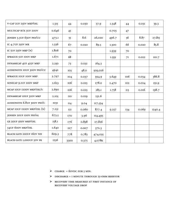

I measured one Hovland capacitor in the sheet above.  It looks to have a good DA rating.  Teflons are expensive, but I find their use to give good value sonically---rather more than expensive cabling.  If you look at my DA test results above, you can see on line six a Customs Electronics 1uF tin/teflon cap.  Its DA recovery voltage measured ave. 0.170V thereabouts, which is very low for a 1uF cap.  The Solens, for their part, measure DF quite closely to the CustElec cap, suggesting a similar DA.  This is, I think, due to their use of a 1000VDC dielectric.  Generally speaking, for two capacitors of the same design having different DCV ratings, the higher DC-rated cap will give a lower DA figure.  And the Solens being metallized, they're physically smaller than a tin foil variety.  The trade-off, here, is between lower inductance and higher ESR (and whatever else differentiates tin-foil from metallized caps).
On the second page of that chart of results, take a peek at line 5, showing a 10uF 100V Mylar.  Its DA recovery voltage?  A whopping 31V!  That's 180X that of the CustElec teflon.
I think the caps in the output filter on the Ncore are Mylar.

I also ran some tests testing the speed at which peak recovery voltage is attained in the various capacitors I tested.  Here are the results:
Notice the first capacitor.  That cap is a paper-in-fluorinert cap I had wound for me.  True to form with other oil (wet) capacitors, recovery voltage is extremely high.  But its recovery time is *fast.*  Compare its results with results for other PIO caps on page 2.
Fluorinert is essentially liquid teflon.  The variety I used for the PIO cap has a dielectric constant of 1.8, 10% lower than that of teflon.  I suspect the liquid nature (reducing dielectric compression and possibly allowing some form of DA-voltage cancellation through physical movement of the molecules), combined with the low Dk (= low DF and low DA), allowed the fast voltage recovery.  J'speculate.
Fwiw, these capacitors bettered teflons in listening tests I performed.  They were really clear.

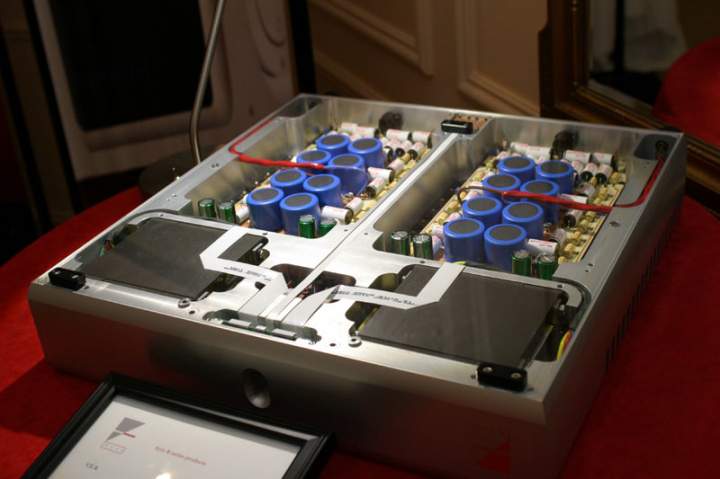

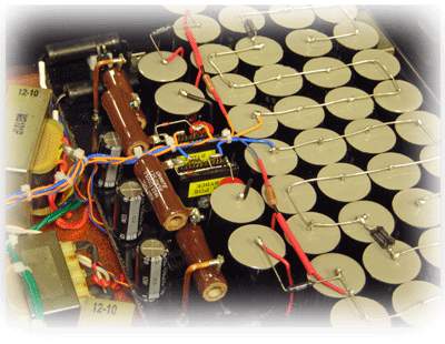

Here are some pictures of the interior of an Ayre VX-R, which sells for something like $15K.  I think they show what Charles Hansen thinks of bypassing electrolytics.  I think the smaller yellow caps are teflons.  The white may be teflons also, I can't remember.

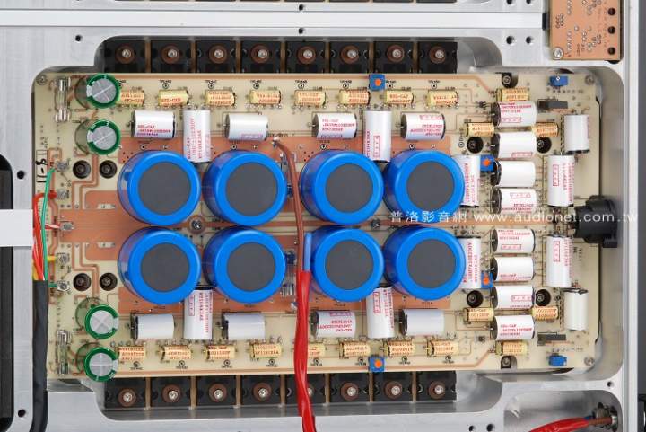

And here is the MX-R mono version.

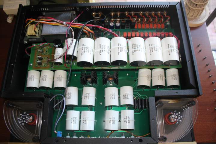

And here is the conrad-johnson Mini-ART and GAT interiors, respectively.  I think the Mini-ART uses polypropylene and teflon caps in its power supply.  The GAT uses teflon exclusively.  Earlier models of the ART used styrenes, I believe.  No or few electrolytics in the B+ supplies (I see one in the GAT photo).

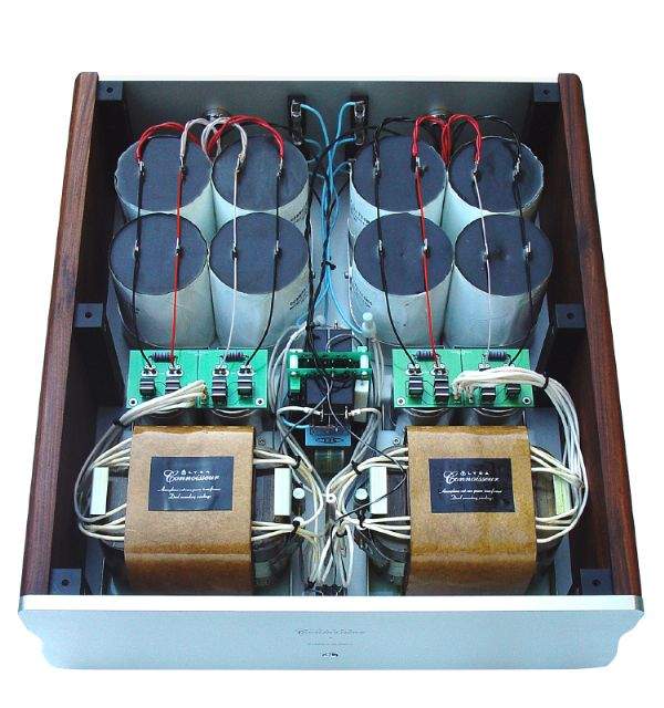

« Reply #169 on: 11 Jul 2012, 04:35 am »
The Lyra Connoisseur.  Polypropylenes, I believe.  Lots of inductance on those power supply wires.  Any guesses why the design as such?

The Purity Ultra GT is a tube unit with a claimed band width of 10Hz-35kHz  -1dB. It doesn't appear to require a power supply that has a low dynamic impedance at RF frequencies.
The Lyra Connoisseur is a transistor based design that is out of production. I could find no information online about the circuit bandwidth. I like size of the power transformers. They must have felt that it sounded better with the polypropylene capacitor bank. I am a little more conservative in as much as my preamp and my phono preamp only have one 225 watt toroid a piece.
Thanks for being willing to satisfy my somewhat irrelevant curiosity about the DA on solid polymer electrolytics.

I'm fairly sure these manufacturers are targeting primarily audio frequencies by their use of psu film capacitors.  Fwiw, the c-j GAT is rated to 100KHz, the Ayre models to 250KHz.

As far as the Ayre VX-R and MX-R are concerned I can't figure out what all of those capacitors do in the circuit. Judging by the positive reviews however, something must have been done right.
My DM 220 amp's circuit boards don't have nearly as many caps, it's an interesting contrast in design philosophies.
My gallery has a few more shots of the amp.

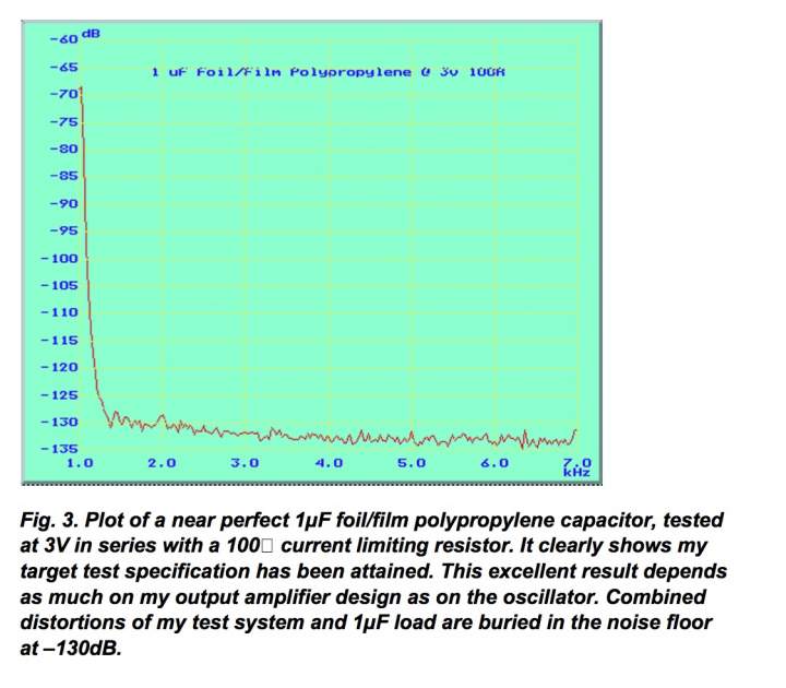

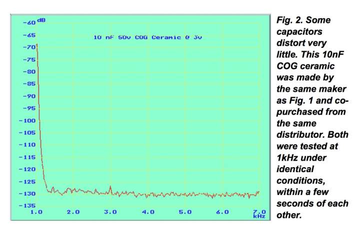

I'm not intending to suggest that using better capacitors solves the world's audio problems.  I do think its an area of easy improvement.  I mean, before Bateman actually measured capacitor distortion, who would have thought this about those tiny smd X7Rs:
I hope Bruno's using COGs:
They're almost as good as film/foil polypropylenes:
Which are nearly as good as polystyrenes (Bateman's measures), which are almost as good as teflons, etc.
