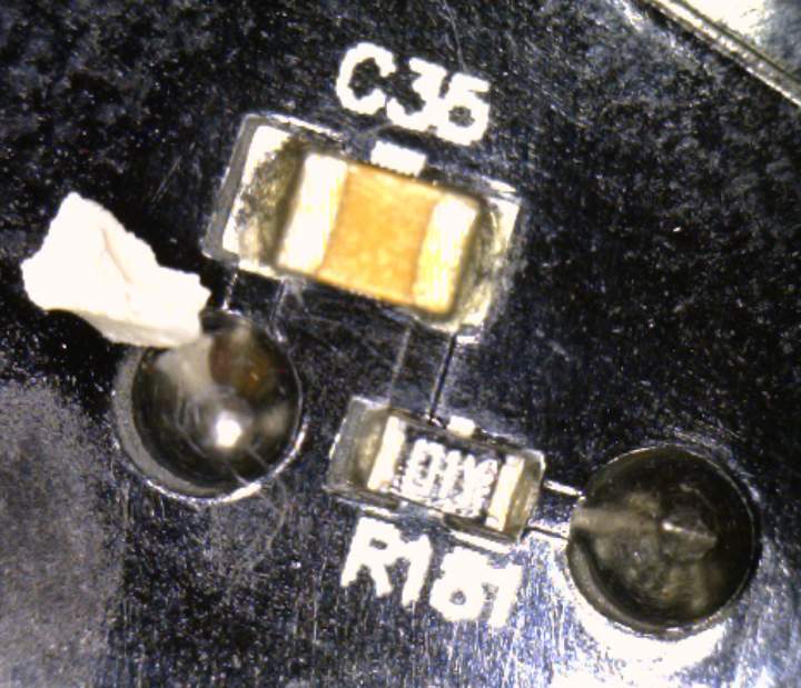

Ncore electrolytics appear to be all bypassed.  Bypassing seems not such a bad idea after all, I suppose.  These onboard bypasses are of course damped, and bypass only for VHF.

And here's the VDD on the comparator.  It looks like the VDD lead connects to the second pin on that unused pin assembly (?) on the top of the board, which should make reading the VDD voltage relatively easy.  Feeding the comparator with a squeaky clean supply looks doable.  Now I'm scared because I'm tempted ...

This appears to be the comparator VDD regulator.  It sits about 1" away from the comparator.

Thank you, R.  Here's a photo of the area in question.  You can see the comparator on the right.  Speaker leads are on the left.  The double array of solder-points is the power input connector.  The power trace (one of the pair passing through the white dot) runs from the comparator up to T77, which you can barely make out near the centre at the top of the picture.  I haven't traced the power source any further.

And a few more of that corner, a bit closer.

Here you go!

 Which camera are you using for that? Those are just excellent close ups. And also fascinating that those tiny caps are also bypassed as well.
It's a Panasonic Lumix portable, the cheapest way I could get a Leica lens.  It puts out 10MB raw files.  I think the one I posted was a 4.7MB jpg compression, which I'm sure this website reduced further.
