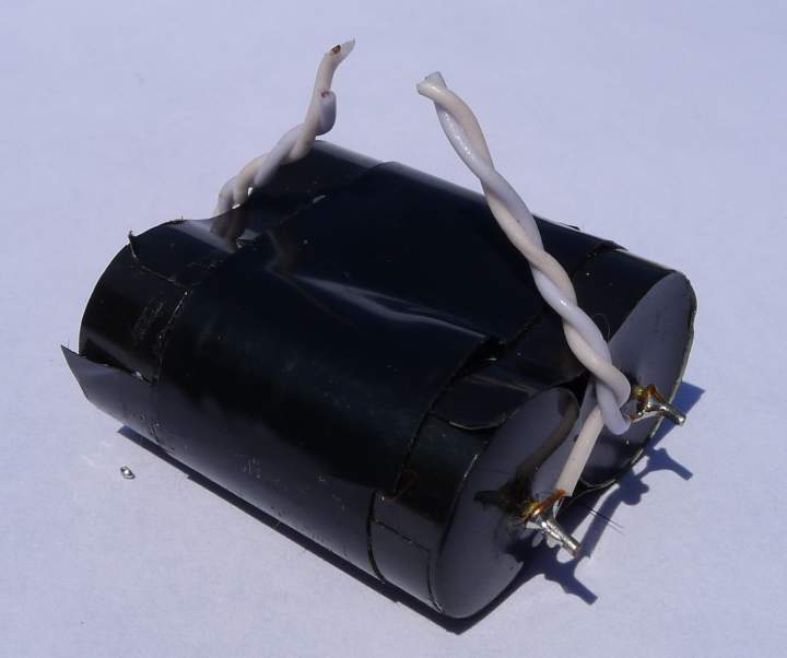

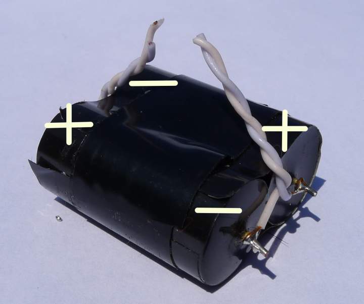

To attach large bypass capacitors to the output electrolytics, I have decided I will use 8 strands of small-gauge litz magnet wire.  Two matched capacitors will be used as a single bypass cap, with two litz wires per capacitor lead, wired as follows (substitute two strands of litz wire per strand of wire in the photo):

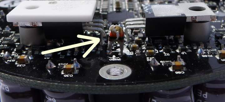

Larger bypasses will be wired as above.  Smaller bypasses (say, 0.1uF and 0.01uF) will be wired with their leads directly soldered to the electrolytic terminals.  Total number of bypass capacitors will therefore include a minimum of three capacitor values to spread any inductive resonances I'm creating.  I may have to ditch the aluminum bottom plate to best pull this off.  That's workable.  There's a small (what looks to be) heat sensor that fits snugly into the bottom plate, but I'm supposing that sensor doesn't communicate with the amp unless the sensor gets too hot.  The output FETs will be well heatsinked, so I'm unconcerned about the sensor.

Here's a clearer representation of my not-quite-inductance-free capacitor wiring.  Cough.

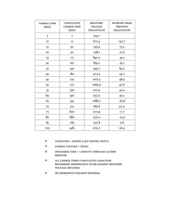

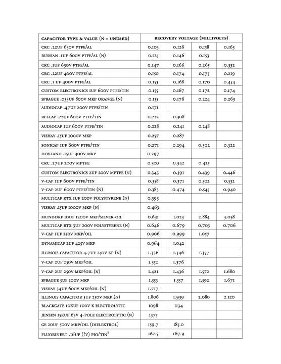

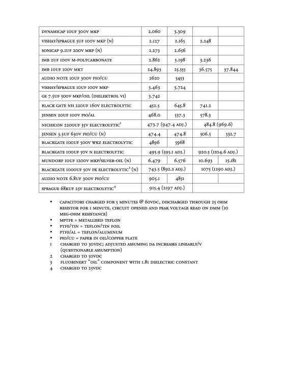

Scotty, I understand that any bypass capacitors will operate in the lower KHz region depending on lead inductance, meaning they won't affect switching-related artifacts.  Per your experiment, and experiments I have performed with class D amps (Tact, Tripath), bypassing to my ear creates obvious audible effects, the overall sum of which I find quite pleasing.

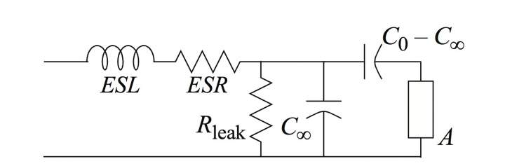

I suspect bypass capacitors help shunt DA recovery voltages to ground.  DA is generally modelled as follows:
You can see from the model that capacitors release spurious voltages related to the original input (charging) voltage at frequencies determined by the parallel RC combinations, the R indicating, I think, a lower frequency given the lagged release.  Here is a graph that purports to show recovery voltage/time after release of the original charging voltage.  Nasty stuff.
How this data reflects a working circumstance is beyond my guessing abilities, except perhaps to say this: DA recovery voltages will carry a frequency related to the overall peak charge/time of a capacitor.  I suspect that the pulse-current on the output of the Ncore (or any class D amplifier) can be decomposed into lower (including audio) frequency and higher (including switching) frequency components.  This decomposition is performed quite handily by the LCR filter on the output.  I don't see why a similar decomposition cannot be performed prior to the output, with L provided by the capacitor leads.  This would suggest the capacitor can operate at audio frequencies despite the high switching frequency, thus removing audio-frequency noise from the output rails.  This is actually what I hear.

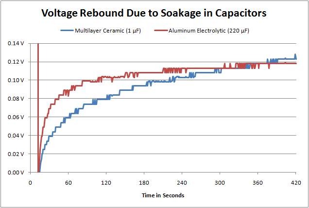

Fwiw, here are a few charts I created to test DA recovery voltages.  I used a good DMM with a 10Mohm input, which is too low for consistent data for capacitors of differing values.  But the charts at least give some correlative evidence of DA effects, particularly for same-size capacitors.
I doubt I've answered your question to anyone's (including my) satisfaction, but what we need is some explanation, however tentative or cursory, to give some insight into what's happening.

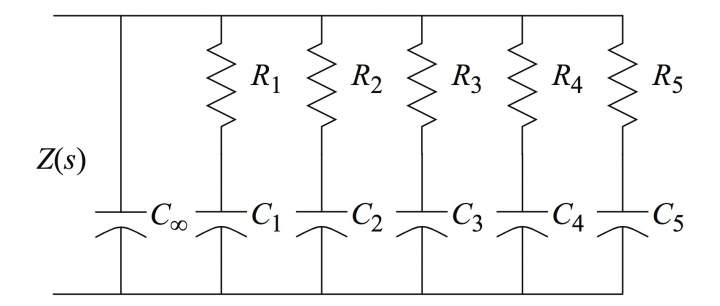

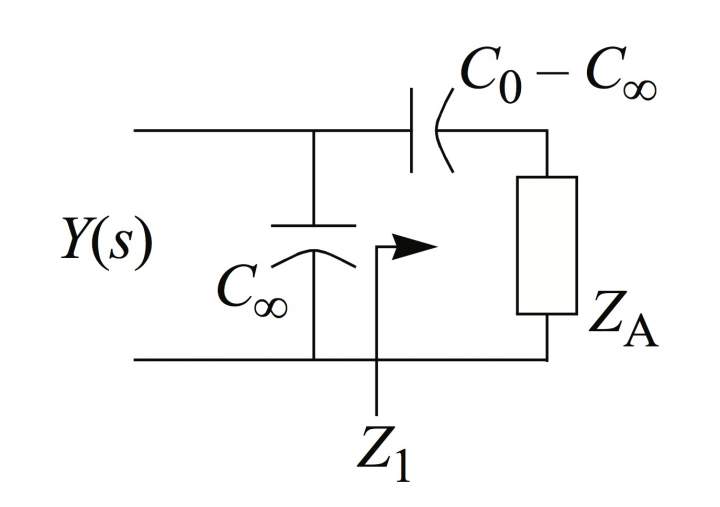

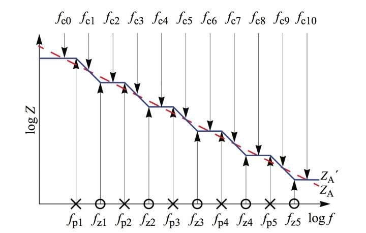

A better model of DA is the Cole-Cole parameter method (graphics below from here: http://www.cktsim.org/modeling/da.pdf ).  This model characterizes DA as follows:
Z[A] is graphed as follows:
... leading to a capacitor model that includes DA, which looks like this:
