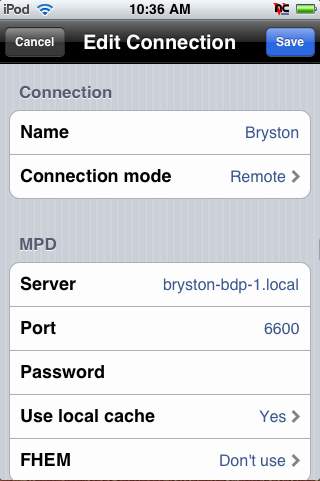

I sent an email from iPhone to computer on same wi-fi network so that worked. Disabled all the Fetch Album Art settings.
I once set it up before; cannot understand why it will not set up now.
Here is what I have tried:
On Preferences screen, I press MPD Server;
On Connection screen, I press Manual Connection Setup;
Brings me to Add Connection screen. Under MPD section, Port is always 6600, never use Password, leave Yes for, Use Local Cache.
 In Server I have tried Bryston-bdp-1.local.  No go. Tried unit IP address, 192.168.1.4. No go.When I hit Save, Error screen comes on and says: "Couldn't connect to the MPD Server."

Here is the setup screen.  If bryston-bdp-1.local does not work then try the IP address.
