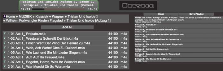

BDP1 definitely able to play m4a, in this case a direct iTunes copy of Lossless cd-rips ( I mean I just copied the m4a-files iTunes made onto the hdd, works perfectly for all lossless rips). No 96 though:
