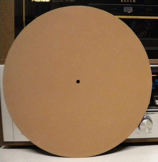

Made of few of these, so I thought I'd share the concept and design. It's easy to make. It's made from .020" thick polycarbonate sheet, that you can get at any hobby shop or JoAnn Fabric store. Mine are round because I have tooling for another of my products, so it was easy for me to make that way. You can make yours square it you want. The center hole can be a triangle (equilateral inscribed about a .285" diameter circle. Or you can drill out the hole for the spindle with a 9/32" drill bit (may have to slightly enlarge it), or a letter L (.290").
The concept is just to cover the platter, where dust can come into contact with the record. Cost of the project should be around $5.

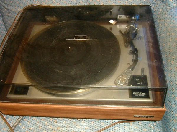

I put a couple handles on my version, i've had it for decades.

« Reply #9 on: 3 Apr 2012, 12:52 pm »
You really need to get something to keep the dust off the rest of that tt Dave.  :?
And the mold too! A little cleaning wouldn't hurt it, you know. :scratch:

I put a couple handles on my version, i've had it for decades. :cry:
dave
God bless that you can live with it for "decades"!!!!
Sorry, I'd never allow my beloved gear look so 'tidy' & 'clean' like yours !  :nono:
OMG................yuck !!

The dustcover has been in my possesion longer than the beater rega ($100). It was a picture taken on a bad day. The dust doesn't really affect its performance (as a dust cover would)

« Reply #13 on: 4 Apr 2012, 02:32 am »
Digital flash pictures make EVERYTHING look dusty! (but that TT is a wee bit dusty...)
