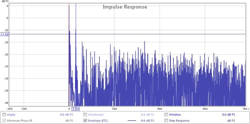

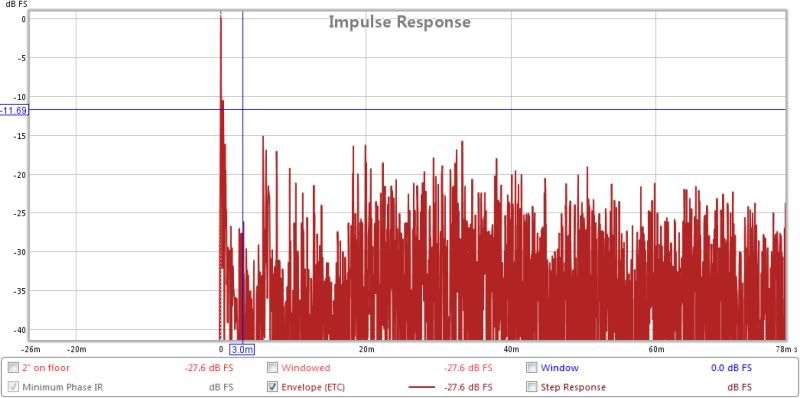

Glenn Kuras
  • Posts: 463
Re: Room Lacking Dynamics
« Reply #35 on: 4 Apr 2012, 05:41 pm »
^^^ Probably not. Those reflections are more of an issue at mid and high frequencies, and two inches thick is plenty. However, thicker panels add a little more bass trapping into the room, which can only help.
--Ethan
Right and to put some meat on the bone  :lol: I did a test just the other day in our test room/lab with a 2" and 4" panel on a concrete floor to measure the impact of the reflection. Basically the 3 m is the bounce and as you can see the 4" did a bit better to bring it down but 2" over all did the job.
No treatment
One 2x4 2" panel spaced 2" off the floor
One 2x4 4" panel spaced 2" off the floor
