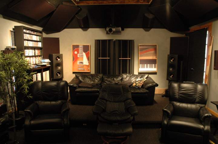

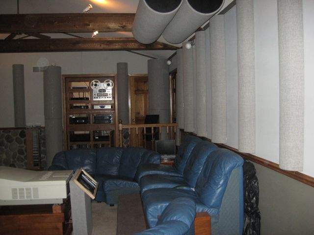

We went a little large with our ceiling cloud.  :)   It's both a huge hanging bass trap  (acoustic inert hangers, etc) and a set of custom diffusers.  It does amazing things to help deepen the soundstage and reduce clutter in the sound.  Clouds are good!
One of the three equal size pieces, during construction.  We used a drywall lifter to hang each piece in place (created template and put up acoustic hangers first), then attached with bolts to one another...ingenious setup by my local carpenter/friend and great design by Jeff Hedback.   :thumb:
side view
front

Ethan and James at Realtraps are great resources.  Their videos are acoustic 101 training guides.  As you can see from my pics, I am a real Realtraps fan.  :)  25 of them at last count (inclduing diffusors on back wall and RFZ's at side 1st reflection points).

Ted_b,do you have a pict of the backwall,THX.
I to am thrilled with what treating the room can do for music even in my 12X19x7.2 room :lol:.
I have a mess of Gik panels which were more affordable for me,now I stepped up a bit and am doing  Ethan's
diffusorsX3 on my partial backwall.
Nice to see those videos as even a small New York Manhatten apartment can sound real good.
The two pieces of art are GIK ArtPanels, on either side of 2 Realtrap Diffusors..

Jeez,just gets better.
Looks comfy too,and I'm sure she sounds superb.
I've seen that pict before somewhere :scratch:, maybe Realtraps site.
                                 thanks for the picts,now for some visualization techniques.
