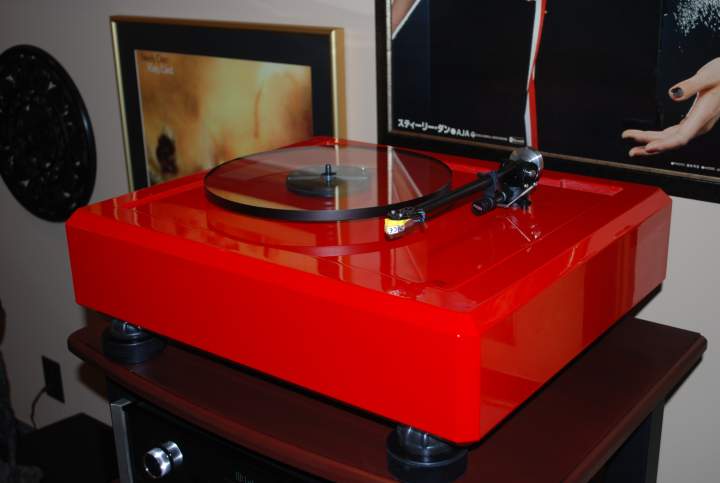

my modded Rega P3..

Wow! How did you do that?

Pretty awesome I'd say.

Re: my modded Rega P3..
« Reply #3 on: 19 Mar 2012, 01:59 am »
Check out the photo of my 2ch system and you'll find a pair of VR5 Anniversaries...that's why I'm here.  Regarding the custom Rega base, it was made by the Amish cabinet maker that built the cabinets for our house and painted by a local luthier.  The base sits upon Pangea sorbothane footers that in turn sit atop hockey pucks.  The Rega table feet rest on an internal granite slab that sits on a 1/4" neoprene sheet.  The whole thing weighs about 60 lbs.

Nice!  So how does it fare compared to the old plinth Gavin?

Well that's the rub Jack.  The multi-pin connector that connects the TT to the PS/speed controller is messed up and won't stay attached.  I need to get that fixed before I can evaluate.  There's no doubt however that the TT is much better isolated now.
