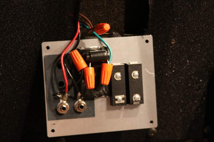

« Reply #28 on: 14 Mar 2012, 12:25 am »
It ends up looking like this. If I blow a fuse, it will be a slight hassle to replace, but it's not really that big of a deal. Thus far, I've never blown a fuse. You can't actually see the fuse - swallowed by the opposing wire nuts. You do see something else that wasn't a factory item though - an RF choke (can't really say that it made an improvement, but I certainly didn't hear a change for the worse, so it stays).
Davey
  • Posts: 1481
Re: 3.7´s, which fuses?....and jumpers?
« Reply #29 on: 14 Mar 2012, 12:55 am »
Chokes and fuses and wire-nuts, oh my.  :)
Dave.
kevin360
  • Posts: 758
  • án sǫngr ek svelta
« Reply #30 on: 14 Mar 2012, 01:26 am »
Yeah, I know - the horror! :o
To make it even worse, I have no interest in replacing the stock connectors. Man, I'm a real sicko. Oh well, they make lovely music. What more could I want?
