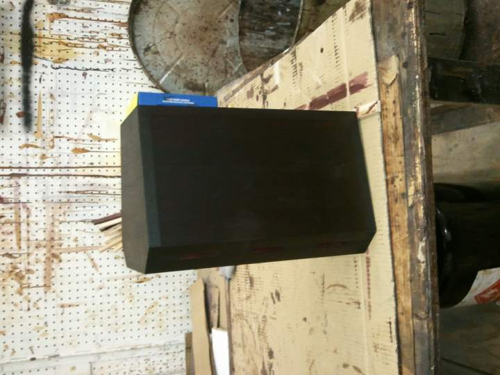

« Reply #23 on: 26 Jan 2012, 10:06 pm »
blacker..  still will start clear this evening....

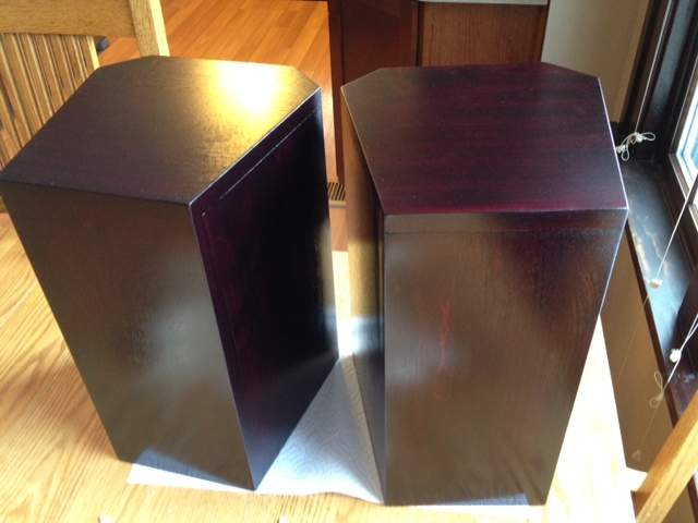

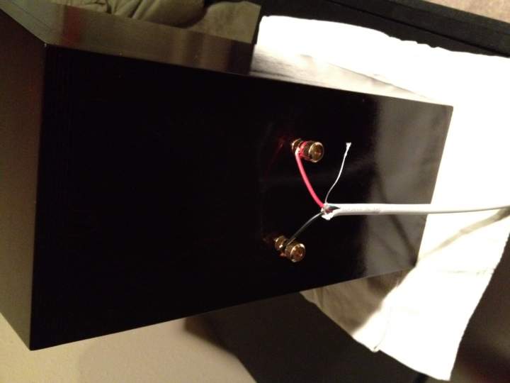

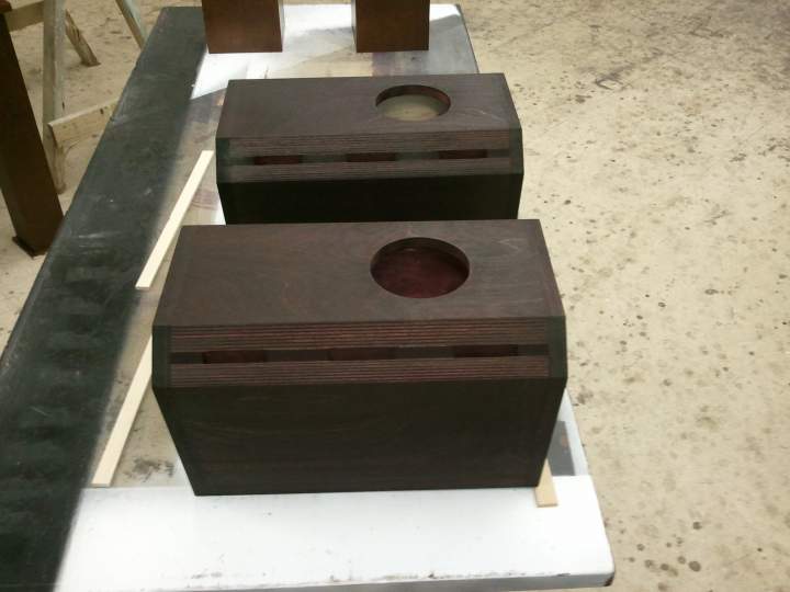

Here is what came out after 8 coats of glossy and 12 coats of stain. I'll put in the binding posts later today and wire them up.

« Reply #27 on: 31 Jan 2012, 05:47 pm »
Fantastico   :thumb:

Well done! Dave's Mar-Ken/Fonken cabs are a superior design IMHO. A fun build process also!
Great job.

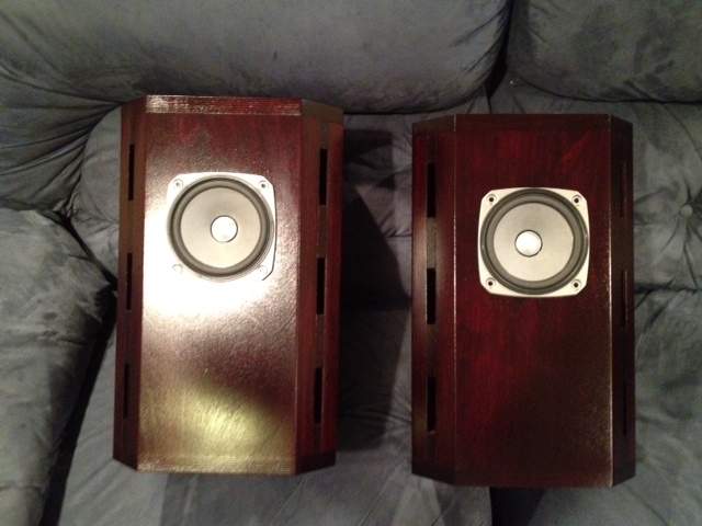

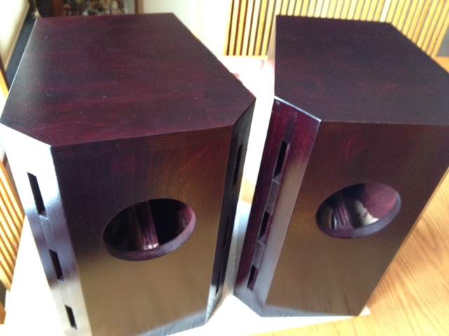

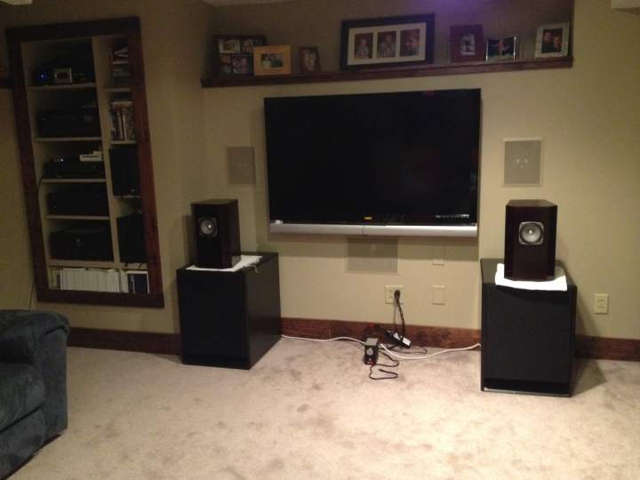

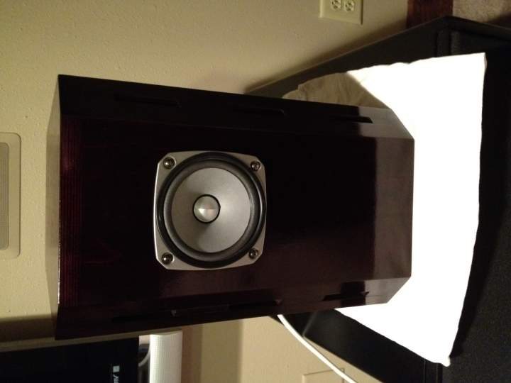

Here is the final product, and very happy with them.  I will put them next to the Frugal Horns and see what they sound like. Please remember that the Frugals are in a extended natural back loaded horn with the shape of the ceiling and wall.  See previous posts.  Will comment later in the week.

Re: Planet 10's new FF125wk dFonken125T 0v8
« Reply #38 on: 6 Feb 2012, 01:18 pm »

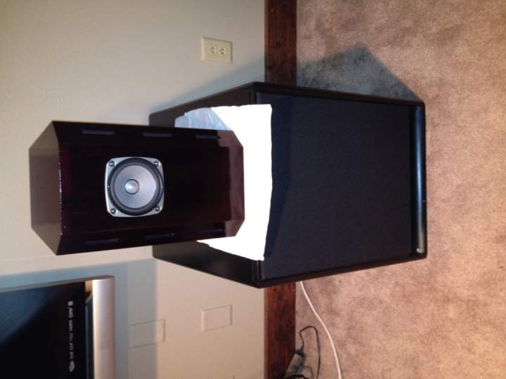

Last one...
