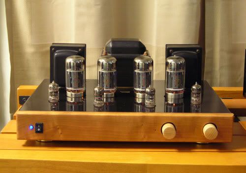

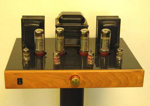

This is what I'd love my amp to look like:

Those are Response Audio's very pretty mods to the  physically larger 302/502, which has much more internal space for tweaky parts, and the elbow room to comfortably work in.
You could of course take inspiration from the list of mods described on the Response site, but be aware that as Bill Baker indicated they both use double sided PC boards, and from my own experience with an over 10yr old 302, the quality of plating leaves rather a lot to be desired, so no matter what mods / upgrades you decide on, take particular care when desoldering and removing components with folded over leads.
As for recapping, the ease and expense of that depends on how carried away you want to get - in the case of the 302/502 there are total of 7 HV caps in the power supply and 4 film or ceramics in each channel of audio circuit, and there have been mods that include additional stages of filtering or bypass.
