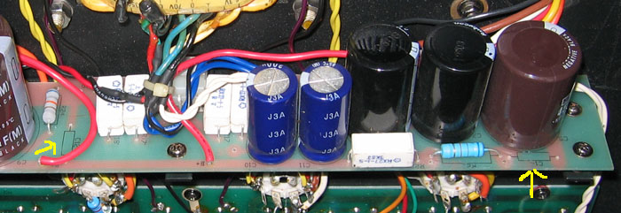

I have opened my 302B (bought in February 2005) but I am not able to see the holes for the 3 extra capacitors. Do you know if the schematic has been modified recently?
In the explanations, its seems that the "after" pictures, page 3 and 5 are reversed, like in a mirror.  Is it possible or did I misunderstood something?
Since I am not expert, I may ask a stupid question: can I remove (unscrew) the PCB, or is it better to let them in place?
  thanks again for your help,
The holes do NOT appear in the schematic.  The do appear on the vertical PCB holding the power supply capacitors, diodes, and resistors.  You will find the holes in this PCB.
Yes, exactly.  This is so that you can see the mods from both angles.
You will have to unscrew the vertical (power supply PCB) to solder some items.  Work gently and you will be fine.
You should not have to unscrew the larger PCB.
If any of this isn't clear, please try to indicate where you need further help.

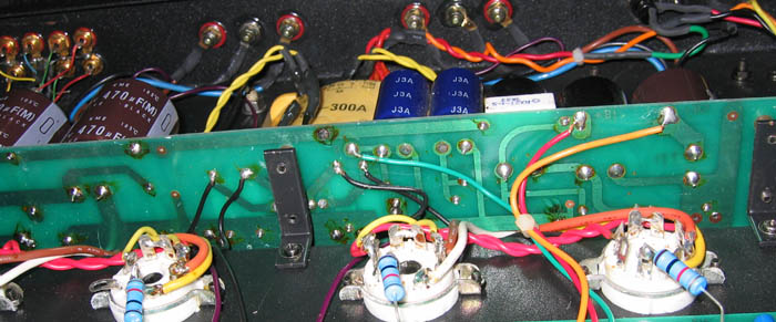

 - the diodes were too short to fit in the holes
 - I did not find the holes for the bypass capacitors.
Here the overall picture, where you can see where I have added some holes:
This shows the problem with the diodes:
This shows how I have connected the capacitor that goes from +B to ground (the hole exists on my PCB):
This shows how I have connected the capacitors that goes from +B1 and +B2 to ground:
I have carefully verified everything before turning the amplifier on, and this works great!
This sounds to be a big improvement with respect to the stock unit, but I have to continue my listening session :-)

Yep, it looks like the newer/different versions of the 302 don't have the holes for the capacitors.  However, your insights are correct and your work looks very clean.
The diodes.  I bent both legs of my diodes outward.  Then at the very ends of the legs, they are bent straight down.  I have bent some of them extremely without breaking.  I believe the diodes leads are quite mallable.  I suppose they could be broken, but I didn't break any.
Your work looks darn good.  Please do convey your results about the sound quality improvements.
