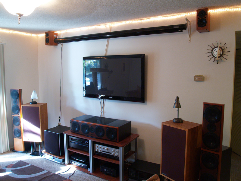

« on: 22 Dec 2011, 03:11 am »
A lot has changed over the past couple of years since I've been on here. I've moved into an apartment 50 miles away with my girlfriend, and I have built up two separate systems, a 2-ch system and a small HT system.
Long story short, the X-Statik's and X-Voce were put out of commission for a while due to lack of space with the growth of the 2-ch system. Also, I've gone through several different speakers including a pair of NHT 2.9's.
Well things are changing again and I recently reinstated the X-Statik's and X-Voce. I went a step further and upgraded my Onkyo TX-SR607 receiver to a brand new TX-NR809 along with not one, but two Polk Audio PSW505's.
After everything is said and done, I forgot how good these speakers sounded. For one thing, I went from a sub-par 6.0 HT system to a full blown 7.2 HT system. Just the X-Voce alone produces such a large, wide and even sound throughout the room with voices, action and music. It gives a lifelike size and feel to the sound, matching well with the 50" plasma and even better with the 100" powered drop down screen. The X-Statik's also produce a very large sound throughout the room. Wide, tall, deep, very three dimensional. When all three are playing, it's a great thing!
Since I have updated the HT system and reinstated the "X-Gang", I haven't even turned on the 2-ch system, and I just bought a 2 month old Monarchy Audio SM-70 Pro amp for that system!
Now I'm pondering the idea of doing crossover upgrades on the X-Statik's and X-Voce if I can be convinced of the improvements. Maybe the Ninja upgrades or just capacitor and resistor upgrades.

Oh, forgot a few pics!  :green:

I was doing some cleaning up around the house today as well as doing a lot of listening. I decided to try what Danny suggested as far as moving the X-Statik's in closer. I was only able to realistically move them out about 4" from the wall however. Not much I can do in this little apartment. Luckily my girlfriend puts up with my BS. Haha!
I have to admit, moving them to the inside positions made a huge improvement! The soundstage has grown even wider and deeper. It definitely sounds better!
Of course, a few pics...  :green:
From my normal P.O.V.
