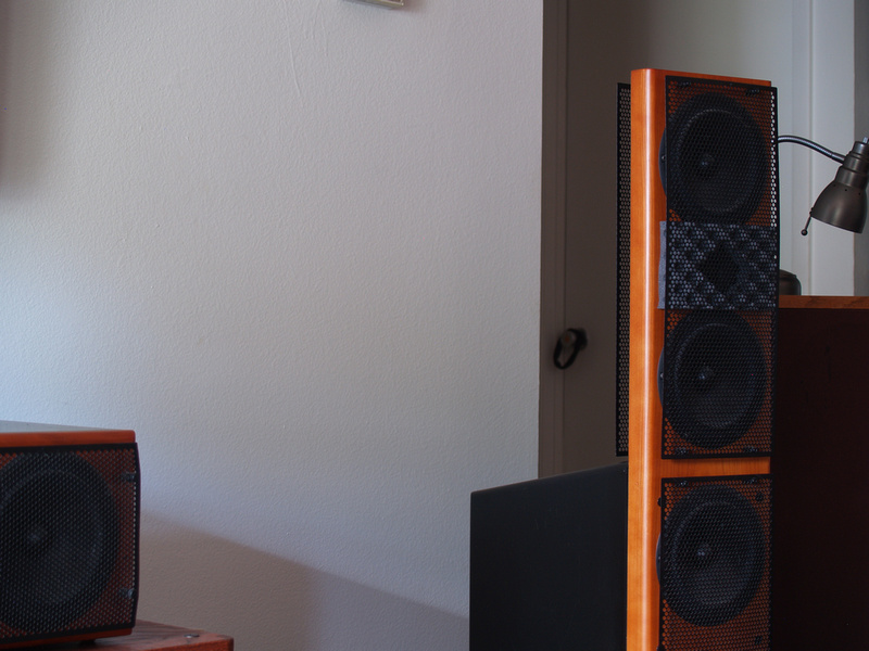

Since I haven't received an answer yet about using felt or foam around the tweeters, I went ahead and put some egg crate foam around the tweeters on my own. Unfortunately, I have yet to do any real listening with this mod as we have company over for the weekend. I did manage to knock off a few pics real quick though...
Danny Richie
Re: Revisiting the X-Statik's...
« Reply #33 on: 31 Dec 2011, 06:47 pm »
That will actually adversely effect the response on these. You will reduce the tweeters output and create a hole in the 3kHz range.

I did something similar to this when I had my X-Statiks.  I added diffraction-be-gone around the tweeter.  It did wonders to my previous speakers but, as Danny mentioned, had the opposite effect on the X-Statiks.  It made the sound hollow and weird.  I took them out after a week and the glorious sound returned.
Chops
« Reply #35 on: 1 Jan 2012, 03:37 pm »
I've given them a little listen today and the only thing I can tell is that it made the tweeters sound a little detached from the rest of the speaker. The foam will be removed shortly.
