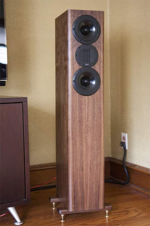

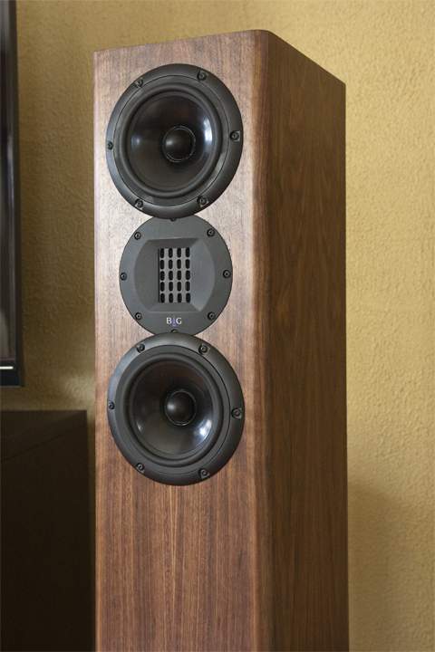

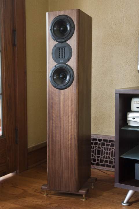

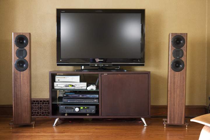

After many months, my N3 towers are finally finished.  They're hooked up and making beautiful music.  Their sound is open and smooth, and their soundstage quite deep.  I'm really very pleased with how they turned out.
I've one concern that I'm hoping I can get some feedback on from the circle.  I've noticed that one speaker is quieter than the other.  It doesn't even come across as less loud, but more like less presence, or less liveliness. I ran some rudimentary tests with a dB meter and a pink noise track, and the difference between speakers is about 1dB.  The problem certainly isn't glaring, but it is noticeable.  The speakers are positioned properly, hooked up to my integrated correctly and I've already switched them, right for left, to determine that it's a speaker issue and not an amp/cable/source issue.
So, I'm sure I goofed somewhere, but now I need to figure out where. I thought I was fairly balanced in my addition of Acousta-Stuff, but maybe put more in one than the other.  Would this affect the balance like this?  Other ideas?  Any thoughtful help would be appreciated.
For now, here's some photos of the finished N3s.  Thanks.
-Brad

Looks like you have a lot of upside potential when you start treating that bare wall behind the speakers.
The only thing in the crossover that can reduce output (but everything still plays) is if you didn't get the cap and resistor that is in the shunt leg of the woofer circuit connected. But that will only make it down in output from about 700Hz to 2,5kHz.
I'll need permission from my wife on room treatment, and she's already been so supportive and sweet about the new giant towers, but I agree, the room needs some help.

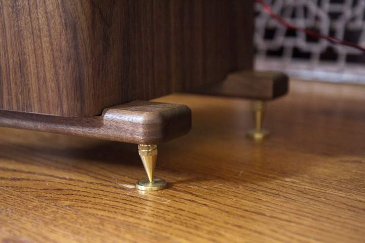

Thanks!  If you want more detailed photos of the outriggers, just let me know and I can snap a few more and publish them here for you.
Thanks, just curious if you had any listening experience between having the speaker resting on the floor vs having them elevated? Any notable differences?
Are they secured to the speaker?
Popular opinion is that spikes on speakers or speaker stands decouple the speaker from the floor and the room, thereby reducing the audible artifacts of room interaction.  The speaker is vibrating less of your room, when it's on spikes.  On the four or five sets of speakers I've had in my system over the last 20 years, I'd agree that there's an audible difference.  Bass is tighter, and the low-midrange seems smoother.  I've also noticed an increase in soundstage width and depth.  If you have carpeting, the spikes allow a solid connection with the wood subfloor beneath.
The outriggers I built are attached to the bottoms of the speakers, yes.  I first drilled hex drive threaded inserts into the base of the speakers (these):
http://www.rockler.com/product.cfm?page=364&filter=bolt
Then, I attached the outriggers by using connector bolts through holes drilled into the outrigger and threading into the inserts:
http://www.rockler.com/product.cfm?page=368&filter=bolt
