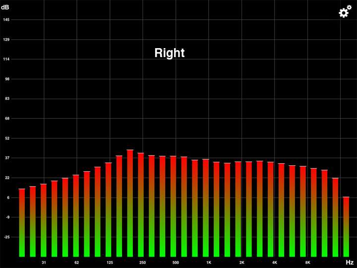

So I'm still trying to figure out the slight volume/presence discrepancy between speakers. I've determined that it's nothing upstream of the speakers, so at least we know that.  The speakers sound great, full range, no frequency suck outs, so I'm fairly sure there are no problems with the crossovers.

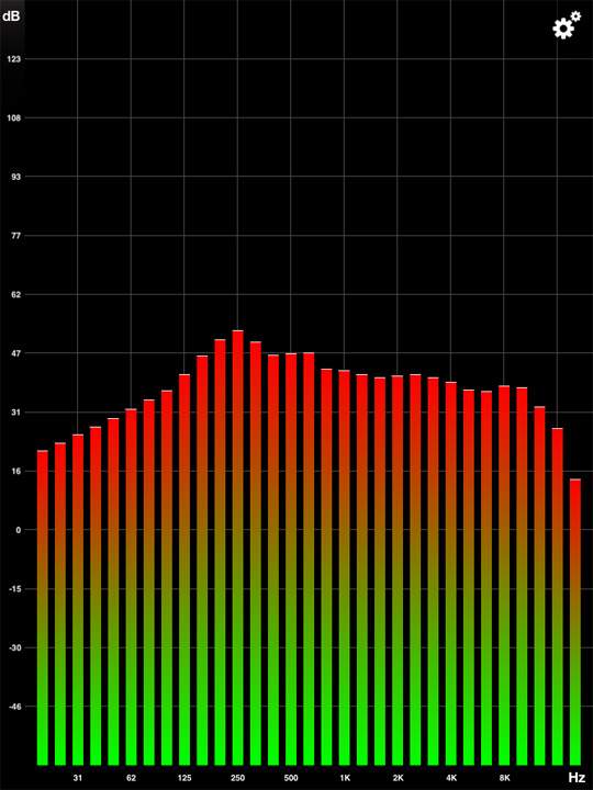

In a "normal" room, what's the freq vs. dB graph supposed to look like?  I took some VERY rudimentary measurements (Octave app on the iPad, pink noise track, built-in iPad mic) and it seems like my bass response drops almost 24dB for the two octaves below around 140 Hz.  That said, I could also be making my measurements improperly.  I've included a screen cap of the graph, if that helps.  Is my room a giant bass sucker?
I thought that for the most part, the graph should be fairly flat to about 40 hz, then start rolling off.

You are not trying to measure both speakers at the same time using the same mono signal are you?

Does the Octave iPad App correct for the iPad microphone response?

You could never get a good graph with the mic you are using don't believe what u see

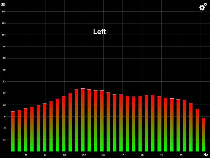

That was the output from both speakers.  Sorry, I'm new to this.  Here are the separate channels.  After reading HAL's and jparkhur's posts though, and doing the research I should have done before posting, I'm sure that the rolloff is due to the iPad's mic response.  It seems to roll off pretty radically right about where we're seeing the rolloff in these graphs.  Thanks, Danny.
I don't think so.  Good call.  I did some more digging and it looks like the iPad mic rolls off right about where I'm seeing it in these graphs.  Thanks, HAL.
You're right, it's the iPad's mic.  I'll see if I can figure out how to run one of my proper mics into the iPad and try again.  Thanks for your help and patience.

« Reply #33 on: 22 Nov 2011, 11:09 pm »
ipods, iPads are all built for the human voice and have built in roll off.  I made the same mistake and just went and bought a good mic to see what i though i was hearing.  a good investment.    I am glad that i am not the only one making mistakes and learning from them.  Lots of good info in here with failures and mistakes by all.   :P   We only get better through sharing our trials and tribs
