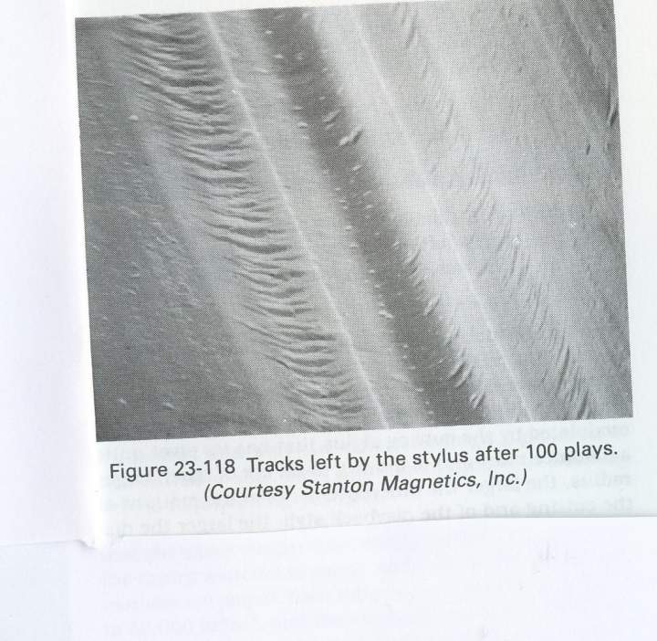

More information on vinyl replay from Handbook for Sound Engineers (1988)

Okay, they are saying with the liquid applied to the vinyl surface, there is no melt from the high temps, then there is minimal to no wear on the diamond or the vinyl?
What is the scouring? That sounds like a bad thing. I'm not sure what I am looking at in the image of the scouring of the groove wall.

The picture shows the gouging and removal of the vinyl that occurs when a very thin layer of the vinyl can't melt at the point of contact. If it can't melt and accommodate the passage of the stylus accelerated wear results.
