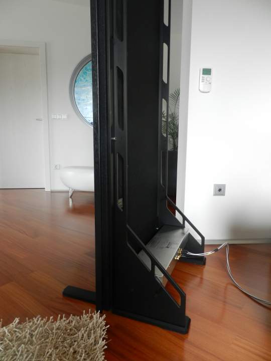

Just recently, I have witnessed the greatest sound transformation at Berni`s home. He`s too shy to report the results so I`m breaking the ice. The stands that he developed are incredibly sturdy and well made, the sound contribution is just enormous. The weight and power in the lower midrange and upper bass is way above of the non-reinforced Maggie, the whole thing is just amazing!
His room is 19.6 by 26 feet that is extending into the kitchen on one side and into stairways on the other side.
Comparing the original and stands reinforced version, there is literally a huge difference. All frequencies below 500 Hz or so, gained in weight, solidity, power and dynamics enormously.

I was hoping to get a small improvement, but I never thought it will turn out so huge. Almost a new speaker in the room.
The only downsize is the fact that my 15 months old boy is now using the xover box as a seat. I don't know why he didn' used it before?? Maybe he was aware of the fact that the original won't take his weight. :roll:

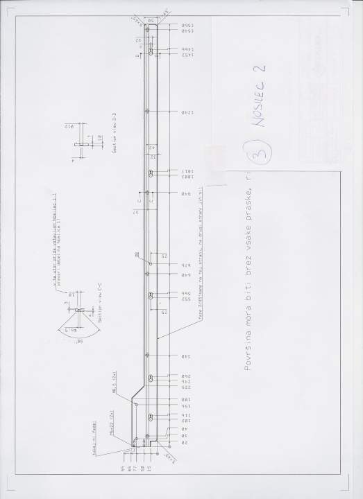

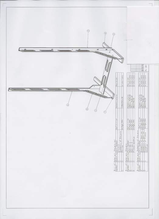

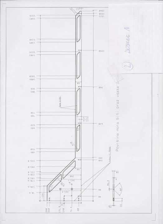

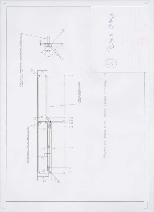

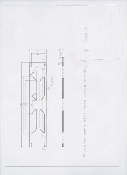

They are made out of 10mm thick solid aluminium, milled, brushed and then black anodized. So there is no magnetic interference.
The most important is the T shaped column(left and right side of the speaker) , with  2,5 inches it gives a lot of stiffnes in the right direction. It is  made out of two pieces which are grooved, so they slide into each other and are screwed together with 6 bolts from the back.
The feet are also screwed from underneath and also have a little groove to assure a tight and strong fit.
All the holes are made exactly to fit the original screws that hold the frame(wood screws), the one for the original feet and the one for the handle. Also this assures a clean and fast installation.
Both of the columns are mounted separetly because of the fact that you must unscrew most of the screws holding the frame. After both are mounted the x-over plate is holding everything together and giving a good support for the x-over.

Diffusion will help , but you will still get a large amount of reflection which will interact with the sound. In this opposite HongKong positioning you get a free and large sound behind the speakers which comes back reflected very late and is not harming  the overall sound so much. Also the back reflection are being reduced as they are near your ears and seem to be almost identical with the  direct sound. You get a good feeling of the concert hall or  the place where the recording has been made.
I'm  in metal working(mostly sheetmetal) so making this stands is not hard. Yes, you need some good machines , but the effort pays off with the sound you get.
Of course you could simplify them. Not milled they could be only lasercut or waterjet cut, but then you lose the fine touch on the edges.
If someone is interested, I can send him the drawing with measurements and positions of the holes.
  If I decide something to be made, then the product must be  much better then the original and must be build, looking and working better then the orignal. Of course they must be well made, everything less is not worth of 20.1 speakers.

berni
  • Guest
Re: Magnepan MG 20.1 magnificent stands!
« Reply #16 on: 17 Nov 2011, 05:25 pm »
Steve, will post some pdf-s of drawings. All measurements will be in mm :green:

berni
  • Guest
« Reply #19 on: 18 Nov 2011, 06:29 am »
Here you go Steve.I cant attach pdf-s,so pictures must do.
