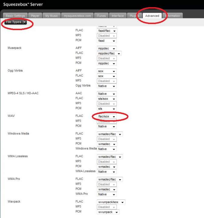

Guys, pull up your Squeezebox console, go to advanced tab (web based interface/ advanced settings)
then once there, go to advanced and do a pulldown on "file types"
Although I haven't used Squeezebox server in years, I still got it!    :)

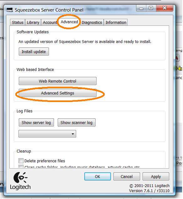

Ed, reread my post please.  Fire up control panel, then under the advanced tab do NOT do "web remote control"!  Do "advanced settings" (the button below it)
Then, if the interface is not to your liking change it to default.

Thats what I was trying to write, I did all that and it opens to some interface like ipeng and displays incorrectly so I can't get to the settings to change interface to default.
 I uninstalled server and reinstalled an older version 7.5.5 and now everything plays back fine and I can get around the settings interface. I totally understood what you were saying earlier. My interface opened to a half baked version of ipengs small display in the corner of my browser and I could not make it go away..
