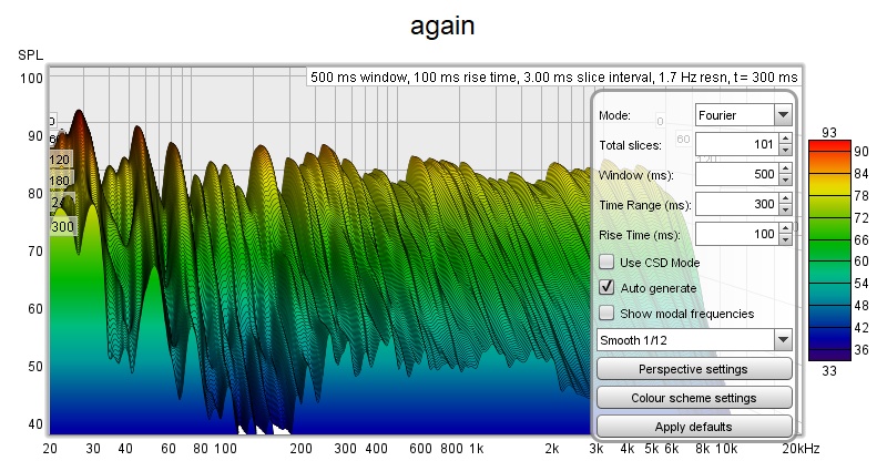

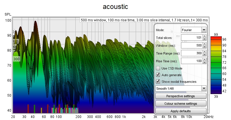

Quick acoustic foams in place, Its helped.

You can can add another subwoofer and place it in a spot that cancels out the peak at your listening position. Read up on subwoofer swarms.

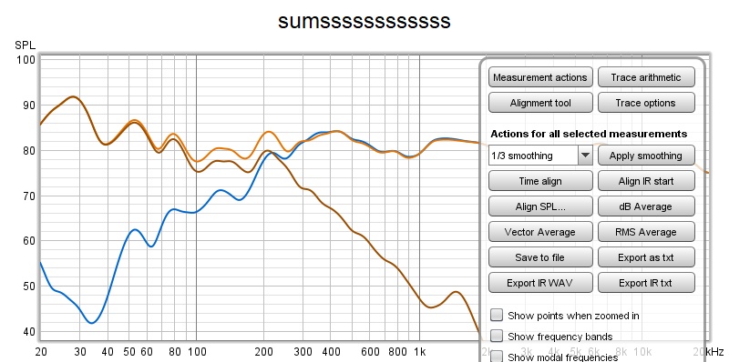

We will listen to this for a while. I was able to EQ the peak a bit. Decays not so hot. Hopefully real room treatments will do some more.

Broadband traps are going to be difficult to knock out a 12dB 50 Hz peak.  Might try changing the location of the subs and/or seating position.
Here is a room mode calculator that may help.
https://amcoustics.com/tools/amroc?l=22.37&w=15.53&h=9&ft=true&r60=0.6

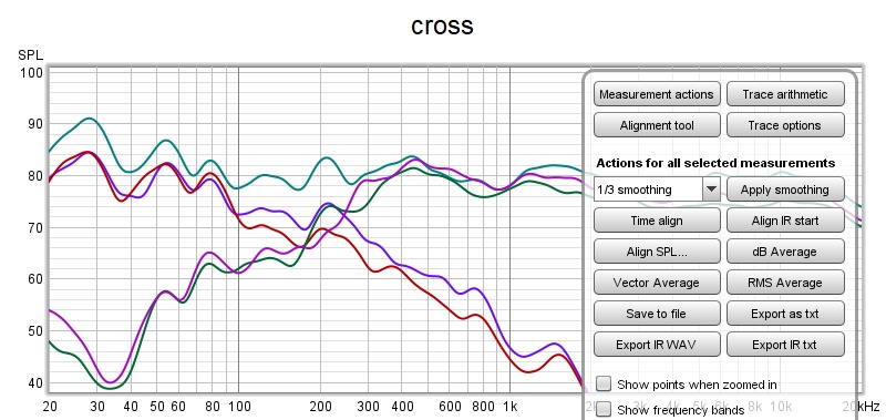

Twisted knobs this morning. It sounds like there's more body in the vocals.
