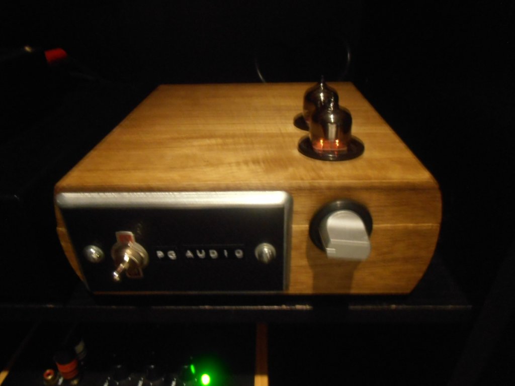

Finally bought the Sain Smart Preamp, about 43 bucks Canadian shipped. Spent my free time the last few days making a box and making this thing look nice. I am happy for sure, sounds good and looks good. I am going to get some better tubes and see how it sounds. I just need to cut the holes in my top piece to accommodate the tubes sticking through.
Poultrygeist
Re: $50 Three Tube Preamp
« Reply #54 on: 12 Jul 2017, 10:24 am »
Great job with the Sain Smart. I did a second one with a premade case from a craft store. Cutting the holes for the tubes to protrude through the top was the most difficult part.

A picture of my $35 Sain Smart with the lid down

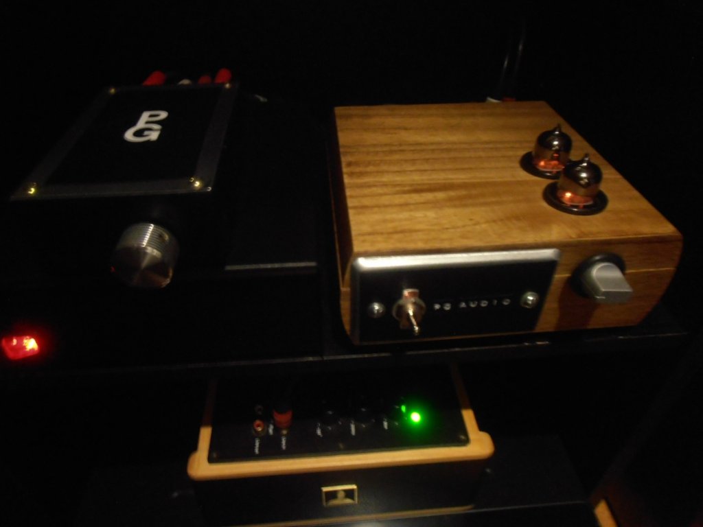

Poultrygeist
« Reply #58 on: 28 Jul 2017, 12:06 am »
undertowogt1
« Reply #59 on: 4 Aug 2017, 12:52 am »
Very Nice. I think I will be adding an ON switch like your in the future.
