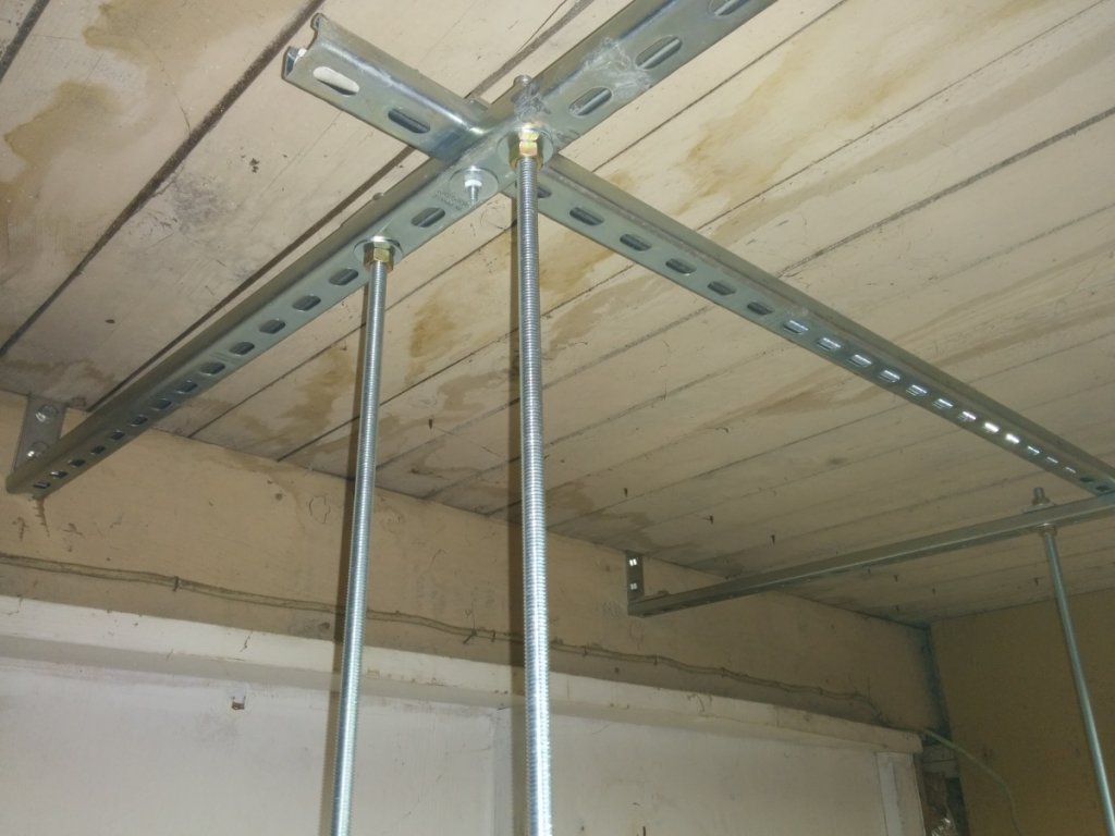

After doing two coats of enamel with roll and tip, I realize I'm just not very good at it.  I was sanding off _way_ too much to smooth it back out.  I needed a different approach.
I've used HVLP before but only outdoors.  I always had trouble with dust and it's getting too cold outside.  I figured I'd give an indoor setup a try.  I built a support structure out of struts and 1/2" threaded rod.  A piece of plywood goes inside the speaker and gets attached to the threaded rod.  That leaves them suspended with all sides accessible.  Suspend a few tarps to contain overspray and voila.

That's an interesting looking rig. how about some close-ups of how you've attached it to the plywood inside the speaker?

« Reply #22 on: 6 Dec 2013, 04:19 am »
As requested, a few close-ups of how the speaker cabinet hangs on the threaded rods.  It sits against the back wall of the speaker cabinet and the threaded rods pass through the holes for the port and wiring cup.
The plywood piece is just wide and long enough to fit through the woofer opening.
Hex nuts and flat washers are used on both sides so it can be tightened down a little more than hand-tight.  I tried hand-tight initially but found that they would loosen up overnight.
Mounting the cabinets on the threaded rod is more challenging than I like.  It's tricky to keep the top washers lined up with the holes in the plywood while positioning the rods to go through them.  Then you need to hold the cabinet up by reaching through the woofer hole and pushing up on the plywood.  While doing that, you need to put on the lower washer and hex nut with the other hand.  Once set up, the cabinets sit well and all faces are easily accessible.

The spraying setup using struts to suspend the cabinets had worked out reasonably well but there had been a few areas that could be improved.  For starters, I used the extra sections of strut (it only comes in 10' lengths) to create a lower tier to mount from.  This gives a little more flexibility in positioning as well as stiffens up the whole support structure.
Last time, I had suspended the cabinets such that the front baffle was facing the ground.  Attempting to spray all 6 sides in one pass turned out to be do-able but only barely.  Gravity-fed HVLP guns don't work very well when aimed upward.  This is probably part of the reason I burned through in so many places.  On the other hand, the back of the cabinet (which was facing upward) was considerably smoother and had no issues with burning through.  Ideally, I want to paint the top and sides, then flip the cabinet and paint the top again.  Additionally, attaching the cabinets to the support structure was nearly impossible.  Holding up the cabinet from inside while attaching a washer and nuts through a driver hole ends up being challenging.
This time, I solved both problems (I hope) by mounting the plywood in the middle of a 4' section of threaded rod.  That way, I can flip the cabinet over and remount it without having to mess with nuts and washers inside the cabinet.  It also means that mounting the cabinet is now just a matter of holding it by the threaded rod and attaching a nut and washer on the top side of the struts.  _Much_ easier.
Finally, there was only a single light mounted in the center of the spray area.  That means that it was pretty hard to see the pattern when working on the far sides of the cabinets.  I added two additional lights on each end of the spray area.  Now I have nearly 200W of fluorescent lighting covering most angles.
