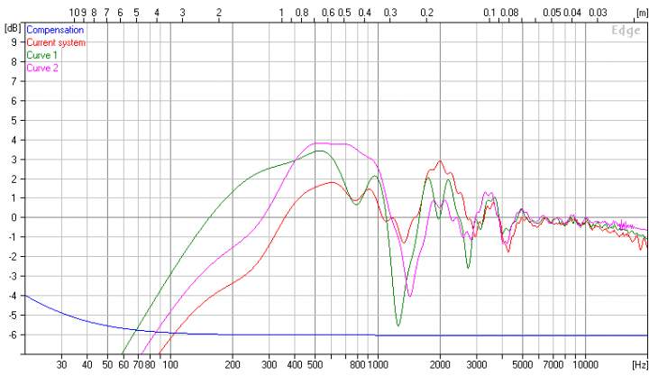

I have been playing around a lot with Edge (as well as with ABC Dipole and BDBS) and I think I have come up with a baffle design that might work - see attached Edge file:
Base design.edge - 1kB
Instead of off-setting the fullrange driver on a recangular baffle, I have trimmed the baffle itself to reduce diffractions. The two 15" woofers would be vertically aligned below the FR driver. To me, off-axis performance (as tested by moving the mic position around) seems pretty alright (save for the normal beaming of a 8" with corresponding roll-off in the treble of course) but opinions and tips are greatly welcome before I get the saw out  :wink:
Bill, my listening is strictly on-axis in the sweet spot, 120 cm listening height. There is no free-standing sub, the woofers are on the same OB as the fullrange driver.
Erling, how would this turn out in your model (SV 215B, AE OB15) for a more complete picture- or can you only model rectangular baffles? Schysta...  :thumb:

Using the MJK model you can simulate a three or four corner straight line baffle and for the specific speaker you will also need TSP-data.
So your six corners are too many. But never the less the Edge simulation will in the dipole peak/dipole hump area be as good as an MJK-simulation
if the element is in itself linear on axis here.
By the way, playing around with your figure in EDGE I could reduce diffraction effects to no more than 1 dB by altering the top three corners
moving sides even closer to the element. So if you don't mind a bit unusualshaped baffle you could design one that could go un-DSPed for shape reasons.  :)
/Erling

I have downloaded MJK's spreadsheets and will play around a bit with them too but if Edge is just as good as far as the shape of the baffle is concerned, I think this design could work. I may add more "corners" in Edge and try rounding the shaved-off part (i.e. making that bit elliptic) which would improve aesthetics.
I also noticed that performance could be improved by moving the side closer to the driver but the trade-off is an earlier roll-off in the bass and I want to keep some space above the FR driver for a possible super tweeter.

But if I use a 8" full-range driver far above its upper beaming frequency and the baffle's dipole peak (and break the rule anyway) as well as DSP, all this does not really matter anyway and it would be better to try to get a bit more bass response out of the FR driver...?
Keeping the optimal baffle width throughout the complete 20-20.000 Hz range would demand a four way system - at least. So you have to make some compromise of course. I always try to keep the baffle shape and the driver position symmetric to the vertical axis - with the driver as near to the baffle top edge as possible.
"Sculpting" the baffle to get extremely flat on-axis diagrams in Edge doesn't lead very far. I simulated the +/- 30° response in your Edge model:
In most cases the best on-axis-response compromises the off-axis response to one side. But don't judge this picture too high. The off-axis precision of Edge looses any precision beyond 15°.
