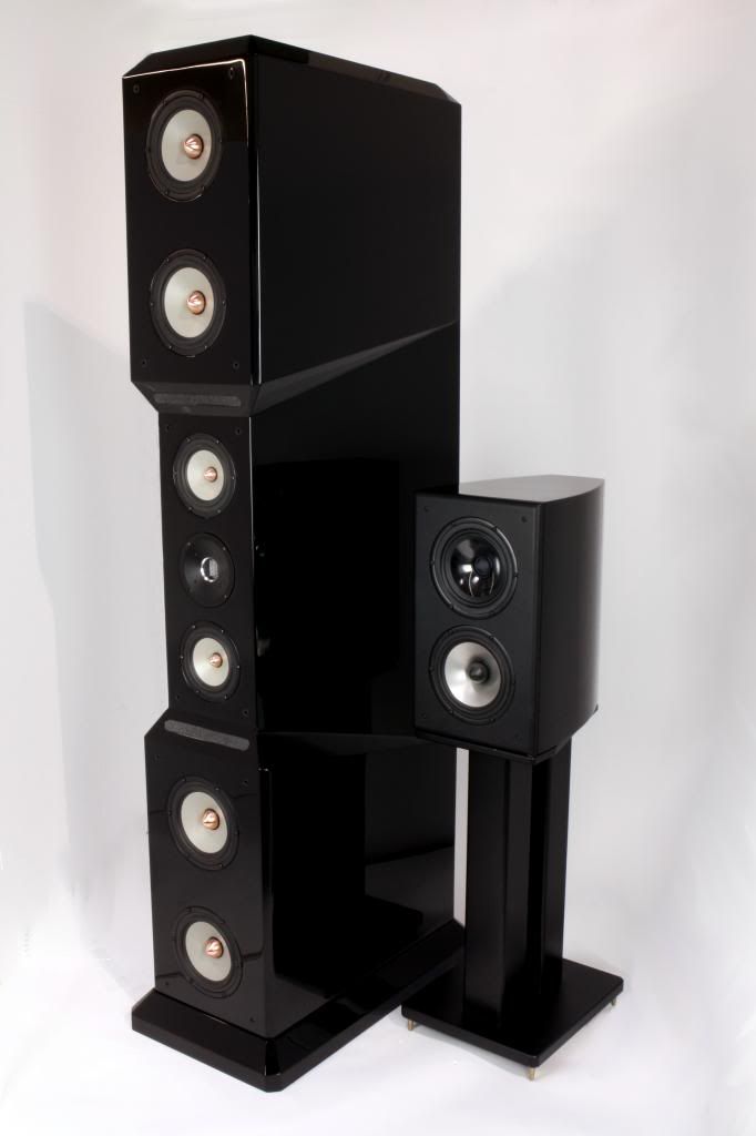

There has been an enormous amount of interest in our new VR-100XS, with many of our potential customers wishing to see some photos.  I am pleased to publish this photo, which shows the large 500lb tower with the UniField Model Two for scale.  Enjoy!

Very cool Albert.  How about a picture of the subwoofer?

Absolutly gorgeous!! Looks very close to the VR-11! Great job VSA!  :drool: :drool: :drool: :drool: :drool: :drool: :drool: :drool: :drool: :drool: :drool: :drool: :drool: :drool:

It would make a great center laying on its side.How tall is it.

It's 180cm tall or 5'9".  To be honest, the first thing I said when I laid eyes on the test cabinet was; "Wouldn't it make an amazing center channel laying on it's side?"  Does that mean that I lose my 2-channel street cred?
