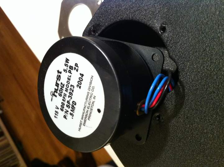

The motor is a Hurst 600 rpm
I'd really appreciate a walk through of any how I may be able to service the motor at home.

OK, that is a 12 pole 3 phase motor.  Can you pop the bottom cover off that motor, and also show a photo of the top where the shaft and bushing are. From what I can see in the photo, it's not too different than the 3001-3009 series.  Probably the same simple fix.  Been fixing that tick-tick-tick-tick in haydon (xa) and hurst (AR and ES-1) for years.

OK, that is a 12 pole 3 phase motor.  ... Probably the same simple fix.
We had a few emails back and forth and I believe that the issue is resolved. Below is the instructions for how I fixed the issue:
OK....there should be a brass collar under that brass locking ring. That has to be set to near zero up/down play. In order to do that, the bottom cover of the motor will have to be removed so you can support the rotor assembly from below.
On the motors on AR tables, the motor housing extends below the rotor. I use a nickel and a dime stacked to support the rotor. That should keep the motor housing from touching the surface and support the center bottom of the rotor. The rotor shaft extending out through the top of the motor should be 1/8th". I use a 3/16' deep well 1/4" drive socket and slide that down over the shaft to set on top of the bushing in that top pocket.
That should only touch the brass bushing without touching the pocket the bushing rides in. I give the socket a slight tap with a light hammer to drive that bushing further down the 1/8" shaft. re check up/down play, and repeat as needed. should you get the bushing too tight against the pocket it rides in, remove the nickel and dime. set the housing on a flat surface and give the shaft a slight tap from top. You should be able to feel a slight amount of play......very slight.
The locking ring may be what sets the bushing, or possibly  what keeps the bushing set. If the locking ring and set bushing are the same piece, follow the setting procedure and then re tighten the locking ring.
Oil it well.
It seems that there was excess vertical movement in the motor shaft that was allowing the rotor to jiggle a bit and cause a bit of rubbing and ticking. There is a brass locking ring that keeps the bushings set in place. The locking ring has probably never been tightened since it left the factory and slid slightly out of alignment.
Possibly I described the noise vaguely or inaccurately which caused the confusion among the other forum members above. I will keep an ear on the motor over the next couple months and update the post if the motor noise returns.

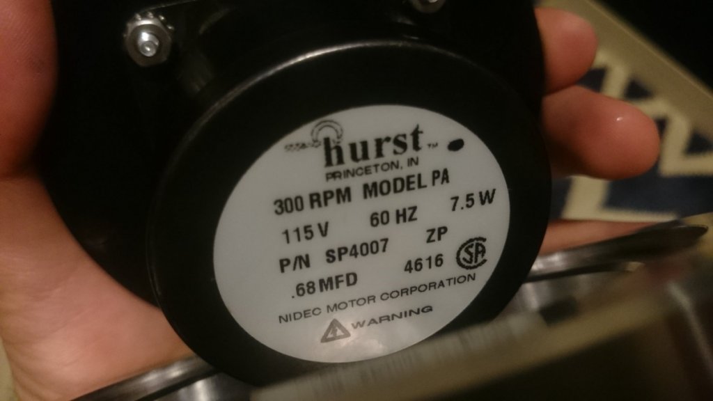

I´m new to the forum and after a little search I found this topic to be relevant to my situation. I live in Brazil and managed to buy a Demo VPI prime unit, made in 2015. Bought it online (music direct) and shipped it to Houston, TX (a friend´s house) and then brought the unit to Brazil after visiting him. The whole process (from buying from arriving to Brazil) took 6 months and yesterday I finally was installing it.
Then the unexpected happened: the motor won´t spin. I turn the power, nothing happens. Removed the pulley, brass ring, still nothing. Checked fuse, changed outlets (120V, 60hz), changed cables, opened the motor base to check the capacitor and wire connections (everything OK).
When trying to spin it by hand, I found it very hard to do it. As if the shaft is stuck! I can be hand spinned but not as gentle and sweet as it should be. The motor makes some loud noises also.
A replacement costs 299 USD (from elusive) or 99 (from Hurst - and I don´t know if they ship it overseas). Is there anything I could do to repair this motor? I´d really like to avoid the need to buy a new motor (there´s no warranty because I don´t live in USA).
