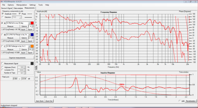

OK, here's the measurements.
First - Just the midrange driver Frequency Response and phase, with no EQ and no crossover slopes applied.  This is our baseline, we can probably make things worse, but unlikely to make things better:

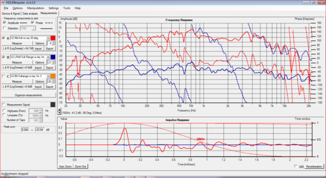

Here is the previous, sharp filters I was using - Linkwitz-Riley 48db/octave (8th order) slopes, set at 80hz and 2kh.  Original midrange only measures are in Red still, the LR measures are in Blue:

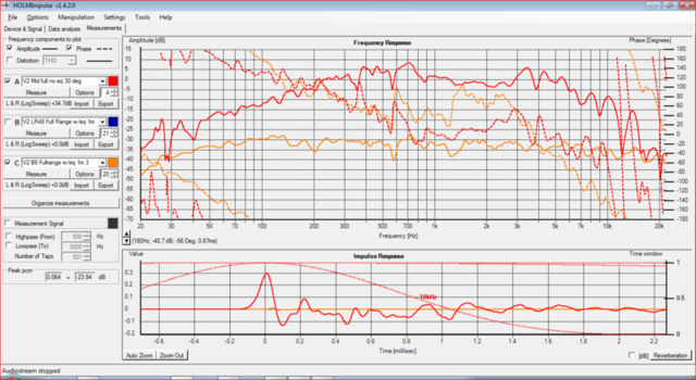

And lastly, here is the measure of the shallow slope Butterworth 6db/octave (1st order) slopes I am using now, along with the "cheat" of using out of band EQ to keep the actual rolloff rather steeper than 1st order.  Original midrange only measures are in Red still, the B6 measures are in Orange:
As you can see, phase is much, much better with this approach, and the Frequency Response I was able to dial in is quite good also.  Sound quality is much higher with this approach, IMO.

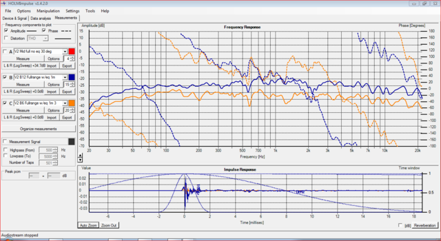

Also, they don't measure quite the same either - the blue line is the Butterworth 12db/octave slope, and the orange line is the Butterworth 6db/octave slope with cascaded EQ out of band.
