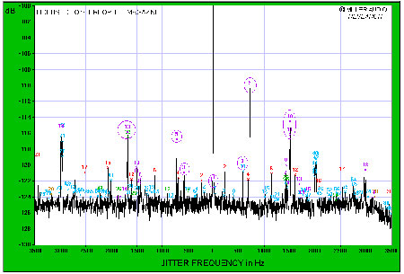

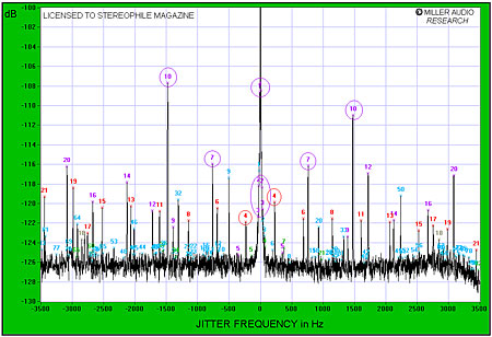

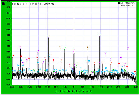

John Atkinson has measured the SB3, Transporter, and the Touch.
His measurement system did change a bit, but I believe the Touch has the lowest measured jitter of the three.
In comparison, I'm also including the measurements for the Airport Express and Sonos.
SB3
Transporter
Touch
Sonos ZP-80
Apple Airport Express
neekomax
Re: What does jitter sound like?
« Reply #10 on: 6 Sep 2011, 08:22 pm »
Those measurements sure are confusing... How does one read them to mean that the Touch has lowest jitter?

Here is an article about the jitter measurements and how to read them.
http://www.stereophile.com/reference/193jitter
neekomax
« Reply #13 on: 6 Sep 2011, 08:57 pm »
Great article, thanks Wayne.
