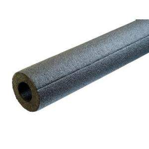

Okay, back to foam.  What sort of effect do you think a diffusor built with varying lengths of foam tubing might produce?  Specifically I am thinking about something like this pipe wrap insulation tubing, that has a 3/4" hole with 1/2" wall thickness for an overall diameter of 1-3/4"?
It's a nice dark grey color, smooth and would only require easy length cuts.  And it is only $1.18 per 6 ft. length.

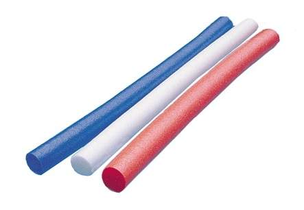

Another idea might be solid "pool noodles".  Although usually in bright colors, they are also available in white.  Solid with no center hole, 2-1/2" thick and about $3.00 / 5 ft. length.
Steve
No idea how a different shape would affect the functionality of a diffusor. Any acoustic engineers watching this thread care to comment?  :)
