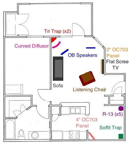

I've taken Bryan's recommendation and have ordered one GIK Soffit Trap.
I'm posting a rough floor plan showing my OB speakers and listening chair and the room treatments I have currently in place and where I plan on putting the Soffit Trap (unless there is a better recommendation).  The total room size is 13 (front)/18 (rear) wide x 26 long x 9 high and includes the living area, dinning area, and kitchen in an open layout.  I have my listening chair and speakers off-set from center to avoid the middle room null area.
The Tri Traps are stacked in the front left corner.  In front of that is a 3'x4' wide DIY curved diffusor (I get a nice balanced image with this placement).  I have a 2" OC 703 panel in front of the TV when listening to cover up the first reflection point (the sofa handles the other side).  I have a 4" OC 703 panel in the middle of the rear wall (but angled into a nook) and a stack of R-13 (floor to ceiling) in the true rear corner (but was going to move them to the rear/side corner as shown).
I was going to place the Soffit Trap vertically in the true rear corner unless someone recommends a different location.  Comments?

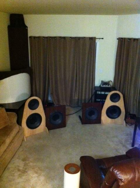

PS: Here is a photo showing the layout and the curved diffusor that "equalizes" the distance to the front wall.  I also placed a small sleeping bag rolled up on the top of the two Tri Traps to see if there was any value to getting rid of the 3 plane corner.

bpape
  • Posts: 4465
    • Sensible Sound Solutions
Re: GIK Tri Traps Ordered
« Reply #13 on: 23 Aug 2011, 01:23 pm »
The Soffit is certainly easy enough to move around and try in different locations - though I suspect where you're going to put it will work well. The other place would be in the corner behind the right speaker/rack as an experiment.
