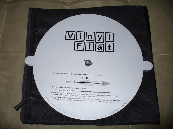

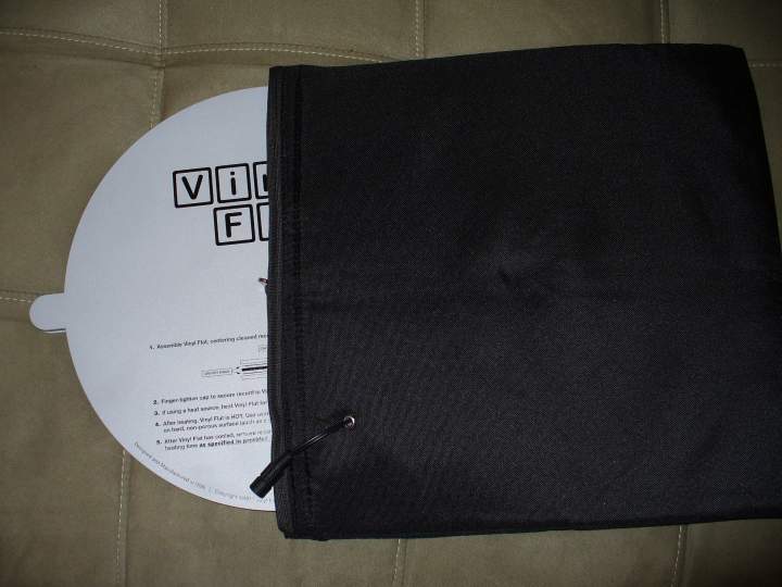

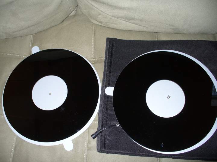

I used the vinyl flat for the first time last night and it really works! I centered a cleaned, but warped record between the two black rings (called Groovy Rings) and placed it on the bottom metal piece, placed the top metal peice over the bolt and finger tightened the wing nut. I then placed the vinyl flat into the Groovy Pouch and plugged the external power supply into the Groovy Pouch. Following the directions, I used a 4 hour heating cycle. After the vinyl flat had cooled to room temperature, I removed the record and played it. It wasn't perfectly flat, but the warp that made the record unplayable was gone and the record is very playable with no degradation in sound. The record was about 135g and I think a 4.5 hour heating cycle might have produced a "flatter" record.
For me, this is a purchase that is worth the $140 for the vinyl flat and Groovy Pouch.
