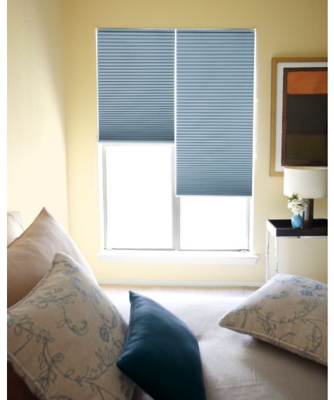

Today I dropped down my hexcomb window blinds on a lark.  Holy crap, the sound improved more from this than several weeks of tweaking crossover and eq settings in my active crossover!!!

What's hexcomb?
  • Posts: 11647
Re: Think OB makes the room irrelevant? Think again.
« Reply #2 on: 27 Jun 2011, 08:05 am »
I have the blackout honeycomb shades -
