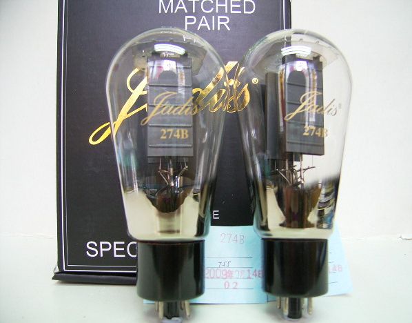

I think I'll be safe and make do with the specified 5R4's that are only available old stock. No point in taking chances with my precious modded/rebuilt W5m's.
Well I did find an alternative.
If I was willing to spend $$, these Jadis 274B Western Electric copies might be interesting.

The 5R4 is a very tough tube, you need to be careful that any proposed Sub is up to the task.
More info, Amp name, what and how many tube it needs to run, Careful with those nice 274B's
