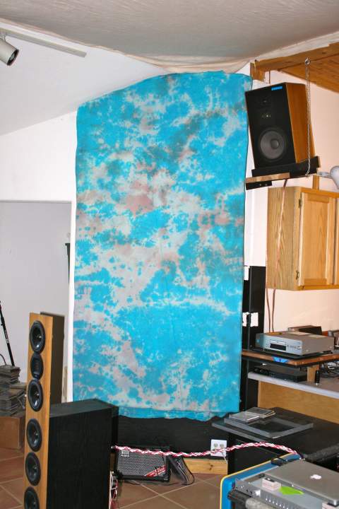

I been working with Jeff Hedback to treat my main listening room, 1st he is great to work with very patient and creative. Here are some pics of the acoustic panel he designed for my room in various stages of the build.  They still need to be covered except the last one which only needs to be trimmed out.
I used an insulation made from old blue jeans rather than fiberglass, suppose to be slightly better acoustically and a lot nicer to work with.
I still have 4 more to put up but the room already sound much better.

Got the covers on last night, still need to trim them out and do the cut outs on one panel(last pic). Played some hi rez I just got, last night and WOW! very clean and focused staging. The bass is the tightest it ever been on my system. If you want to transform you room Jeff is the man
They have HWF because she dyed the covers.
