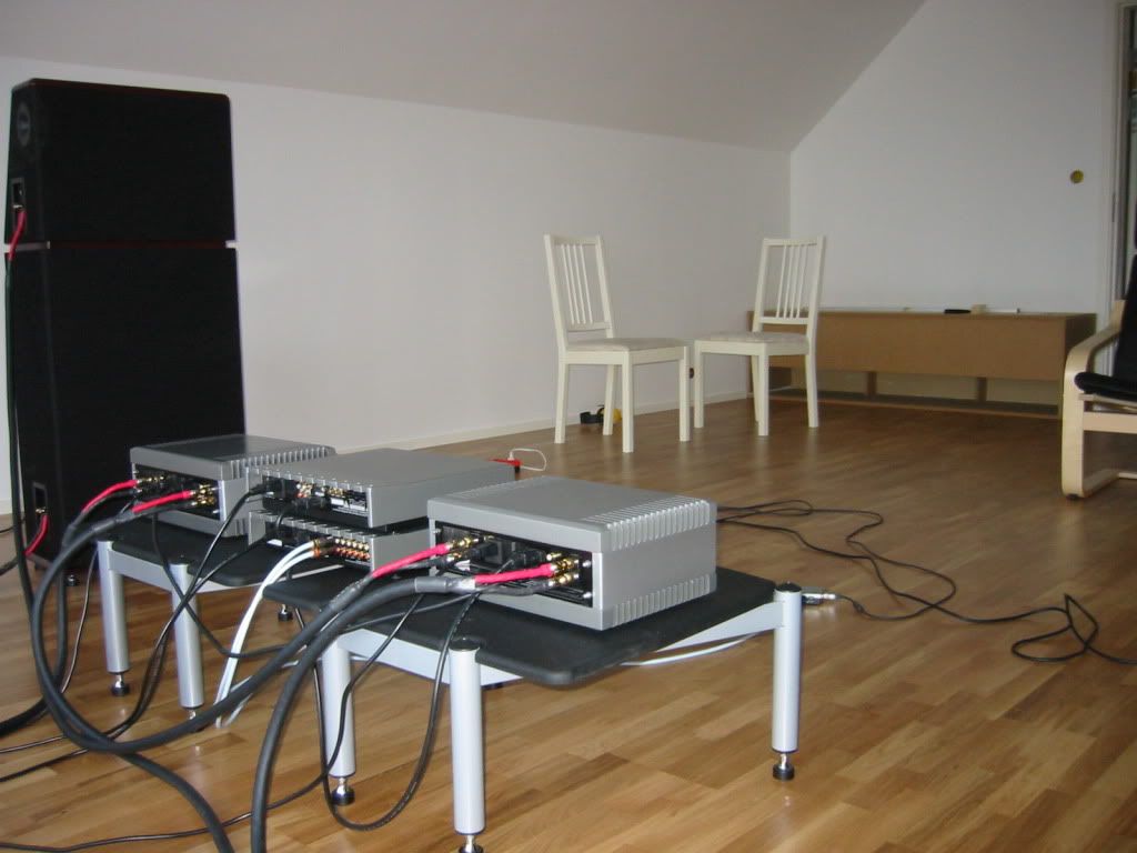

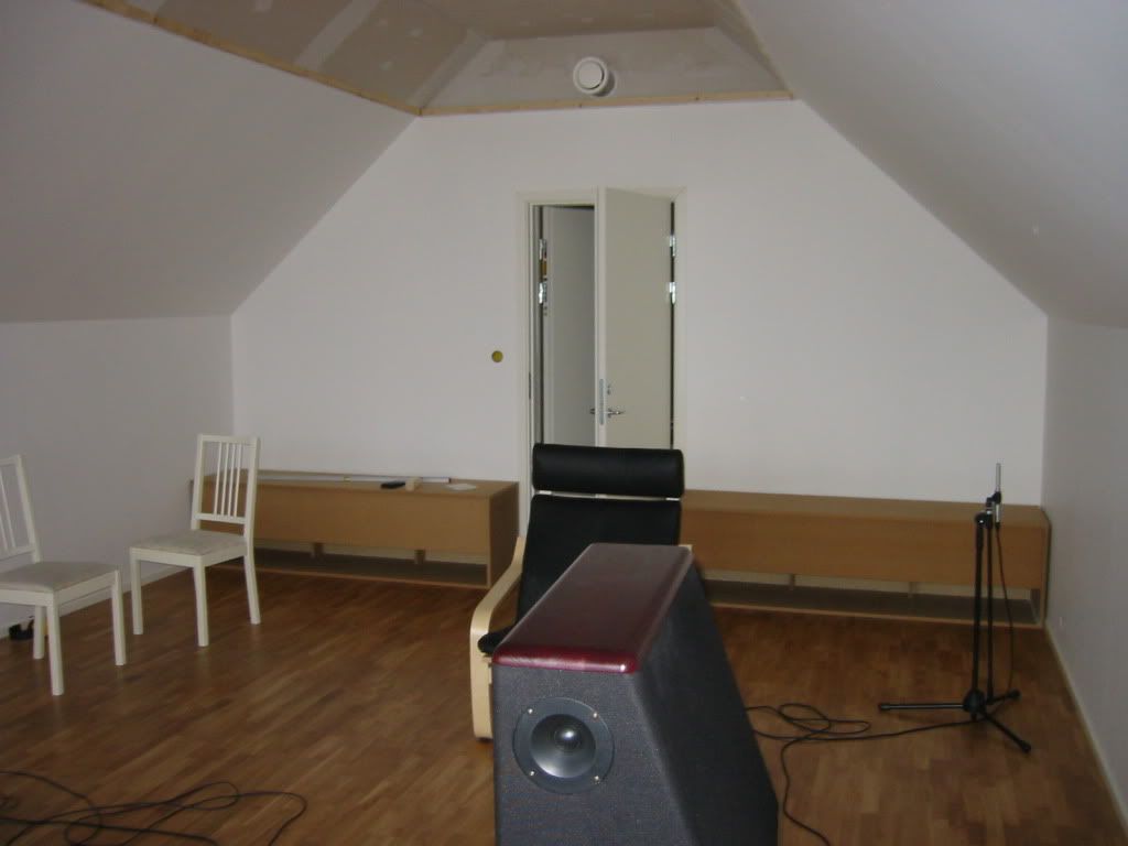

I had the same gear when I started the measurement in this room at the begining without treatements. It look like this
those rear boxes wasen't there when I did the first measurements.
I did measurements step by step as I added more treatment in the room to see if I was going in the right direction, acoustically.

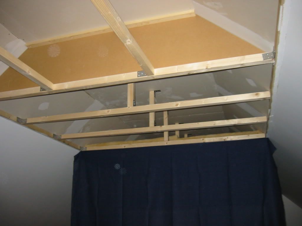

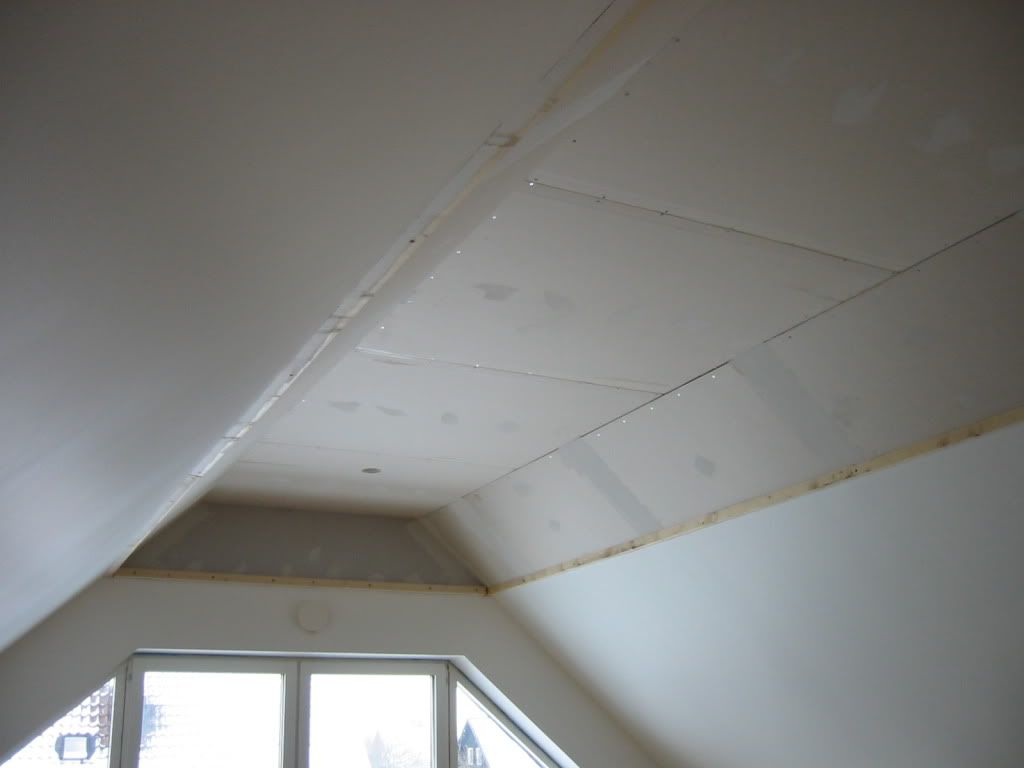

I started to treat the ceiling first.

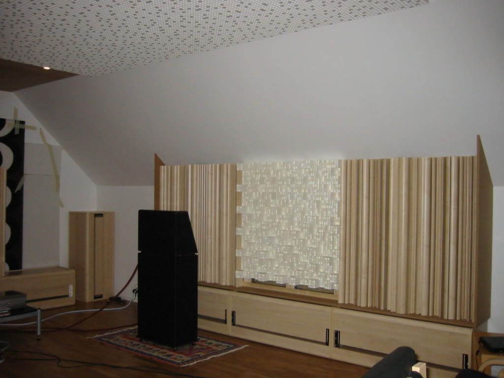

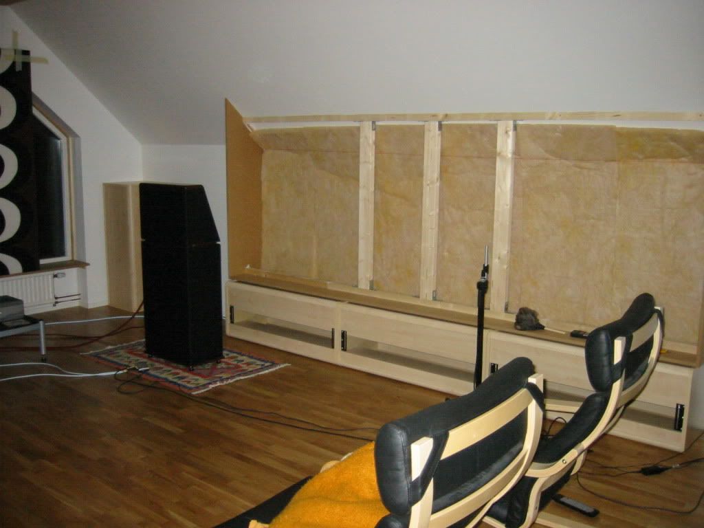

then side walls, with Helmholtz resonators
This is the final point where I coulden't treat any more due to space, I had almost filled every corner and wall as possible with treatments.

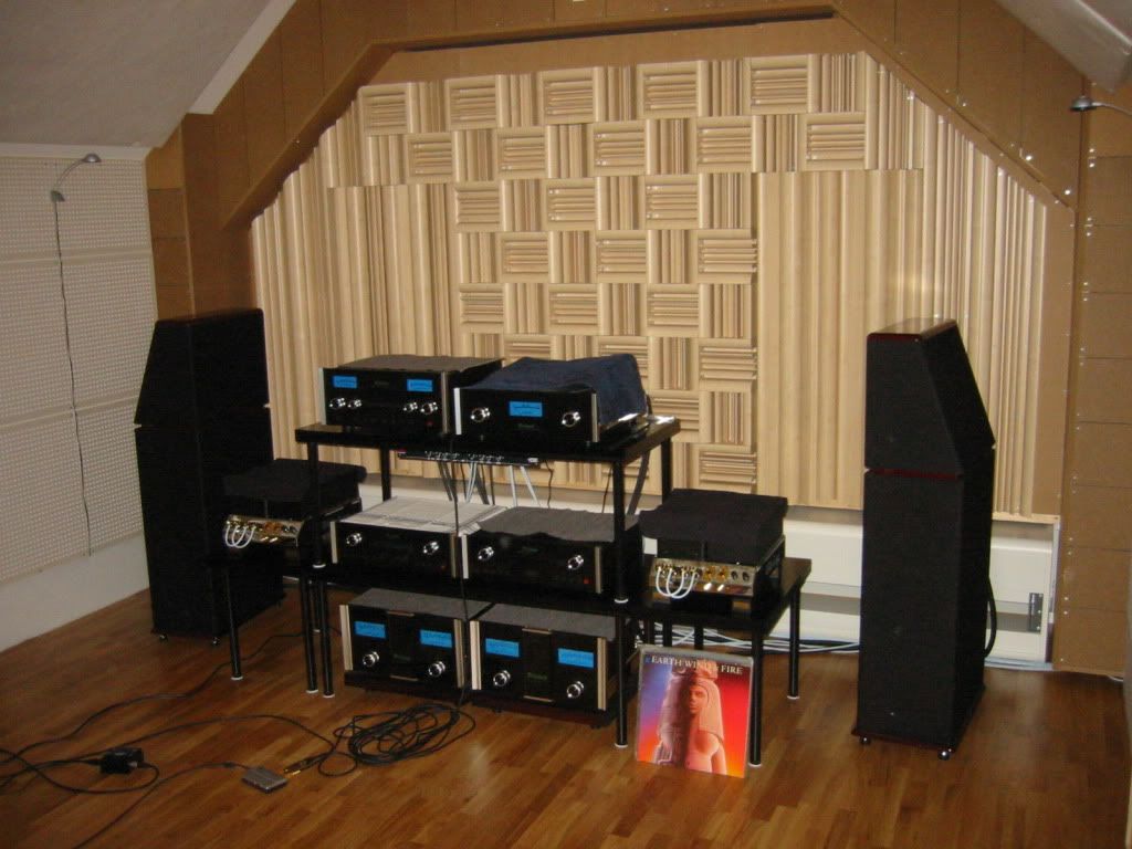

Pretty much the same as in the first post exept for the speakers and more extra bass.

All walls have trippel layer plasterboard with damping glue in between. The floor has trippel layer 1" fiberboard with damping glue between. The room is very robust and stable, bare in mind that this is on the second floor.

This is my current setup and I am finally done. :D :D
