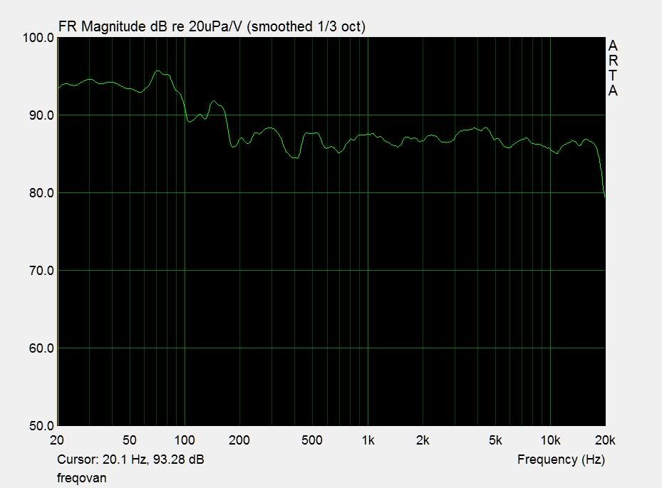

Hi
Here is my room and some measurements.

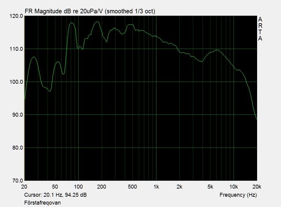

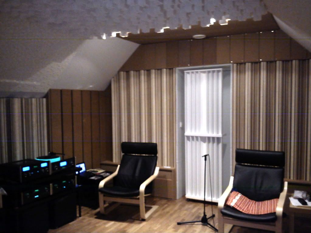

before treatments it looks like this
and after treatments it looks like this
there is no resonaces and it has freq response in the bass region +/- 3dB from 20-100Hz.
Remember, I have done it myself :D
Thanks

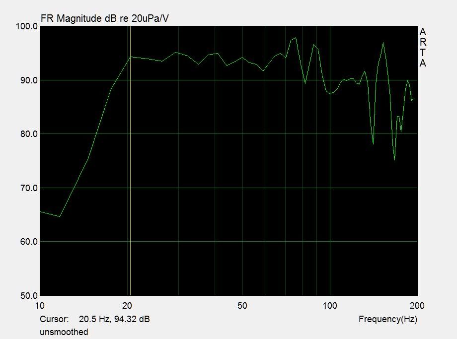

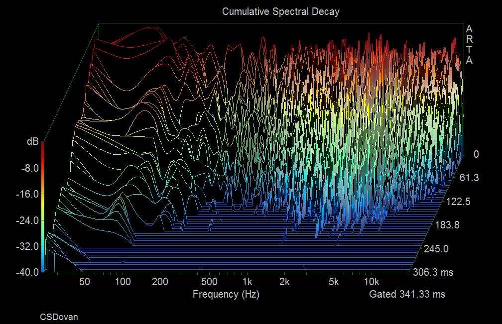

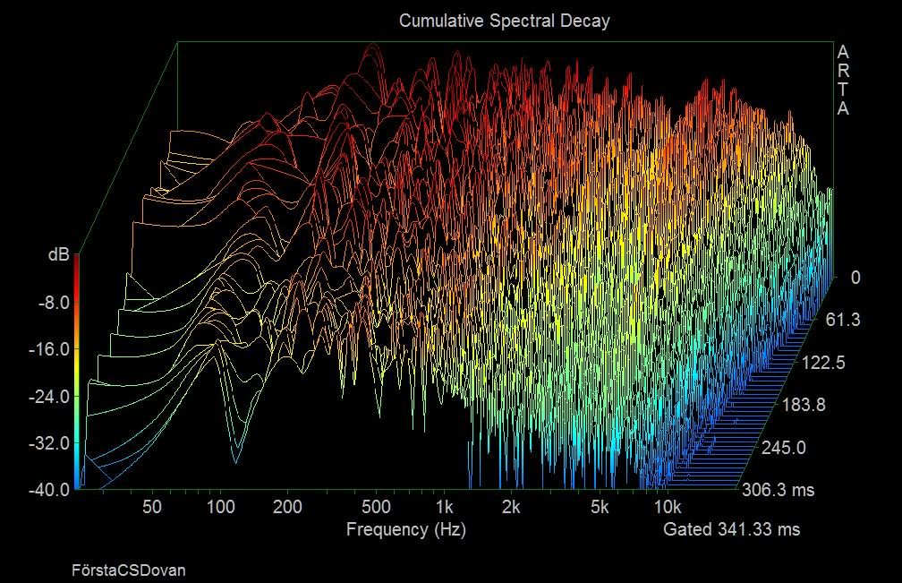

Please post your curves *without* 1/3 rd octave smoothing below 200 Hz.
Your room obviously measures nice, but I don't believe in 1/3rd octave smoothing below 200 hz when you want to concentrate on detail ,even though the ear does average things out in that region and has poorer resolution in the time domain.
The improvement in spectral decay is quite noticeable!
Provide some details on your room treatments, there is some serious diffusion going on there!
Nice speakers. Controlled directivity is key.
Anand.

Hi
Here is unsmoothed
The diffusion stuff comes from Matts Odenmalm SMT AB, Sweden. But you can get them in US as well from  www.performanceacousticslabs.com

« Reply #15 on: 4 Jul 2011, 12:31 pm »

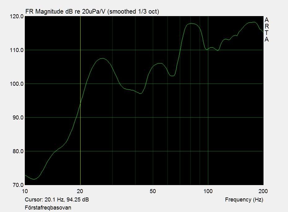

Sorry... but, is this correct? There are no changes between these two graphs other than room treatment?
Thanks ;)

JohnR
Re: My room
« Reply #17 on: 4 Jul 2011, 02:15 pm »
Hi, I'm asking if there were other changes, more than just the room treatment, between those graphs - ?

JohnR
Re: My room
« Reply #19 on: 4 Jul 2011, 04:52 pm »
Hi :) I'm just asking if you changed anything other than the room treatment between taking those two curves, e.g. spaeker, crossover, speaker position, mic position, eq, etc.
