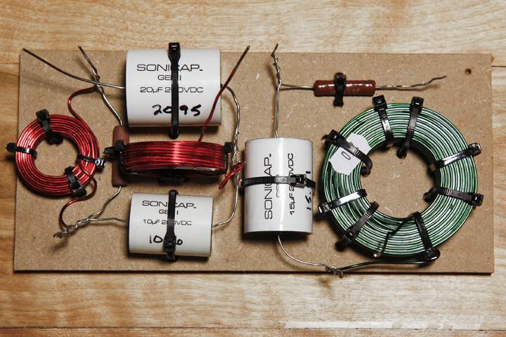

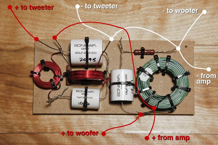

I'm building a pair of the N3 towers, and I've finished the crossovers.  Before I solder and glue everything into place, I was hoping someone whose built these before could check my work.  This is the first network I've built and any expert guidance would be very much appreciated.
The first photo is just to make sure I've connected the components properly, and the second is to make sure I know how to wire them up.
Thanks in advance for any assistance anyone can provide.
Brad

 I have previously built several pairs of N3S and a pair of N3 TL towers. Your crossover layout and connection points look correct to me. Good job!

Looks good.

Hi Brad,
Looks great!
If you haven't already, you may want to consider adding some hot melt glue in order to prevent any resonant induced rattles.

Re: N3 Crossover Construction
« Reply #8 on: 30 Apr 2011, 06:56 pm »
Hi Ruben,
Thanks for the photo!  Now that I know the crossovers are built correctly, I'll go ahead and solder everything together and glue everything down.  I wanted to make sure I didn't have to dismantle anything before fixing it all permanently into place.

 I agree with Ruben about using hot melt glue under each component part to reduce resonance. In addition to using this same method myself, I also like to use plastic tie wraps around each component so that they don't pull loose from the board as shown in the attached picture.
