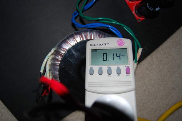

« Reply #13 on: 5 May 2011, 12:19 pm »
How do you get 140x8=1,120 watts of output when it only consumes 800 watts?
The same way you get 250 watts output and draw this amount of watts:
Amps:
www.classdaudio.com

« Reply #14 on: 5 May 2011, 01:48 pm »
I guess I'm still missing something here, unless the laws of physics have changed.  Even a class D amp will dissipate a small % of power consumed as heat.  And is the Marantz even a class D amp?
The real answer lies in the details. From a review @ hometheater.com.
"While the two-channel amp’s output doubles into a 4-ohm load from 110 watts to 220 watts per channel, the MM8003’s manual recommends at least 6 ohms. It warns that a lower impedance load might cause overheating that could trip the unit’s protection circuits. In addition, the unit’s 140 watts per channel into 8 ohms is specified for two channels driven, not eight channels driven."
As expected, there are no miracles here, just the typical overstating of performance we see for most A/V products.  If you look at the specs for the Outlaw amps you'll see more of what you would expect for a higher quality multi-channel HT amp.  I'm sure this Marantz is a very nice unit, but it's simply not in the same league as the Emotiva/Outlaw/ATI units.
