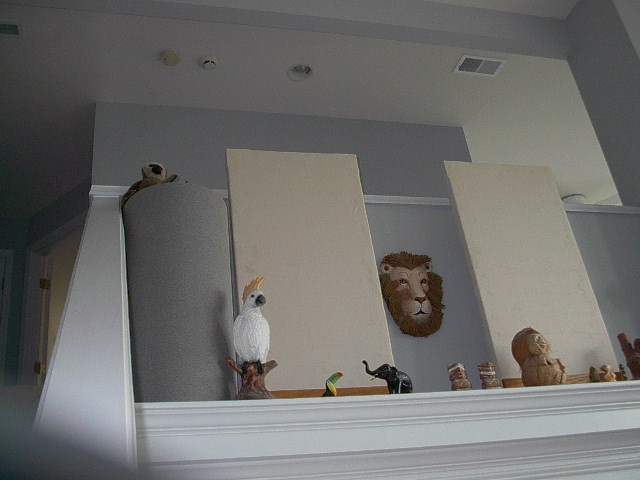

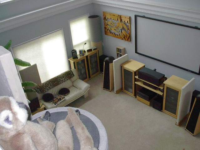

You can buy pipe insulation from insulation distributors and cover it. In the pic below of the main room entrance the bluish gray trap in the upper right is 17 inch pipe insulation. A friend built it. It has wood on top and bottom and his wife put the material on.

Here's a couple of shots of the DIY bass treatments from pipe insulation so you can see them a bit better. The midrange absorbers (2x4 feet) are DIY from readyacoustics.com and I just made stands from oak (vs. hanging them on the wall with hooks they provided) and they have several shades of microfiber covers and also thicker insulation more suited for bass as well.
