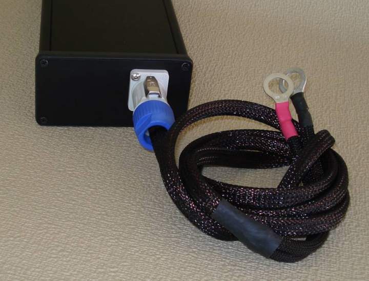

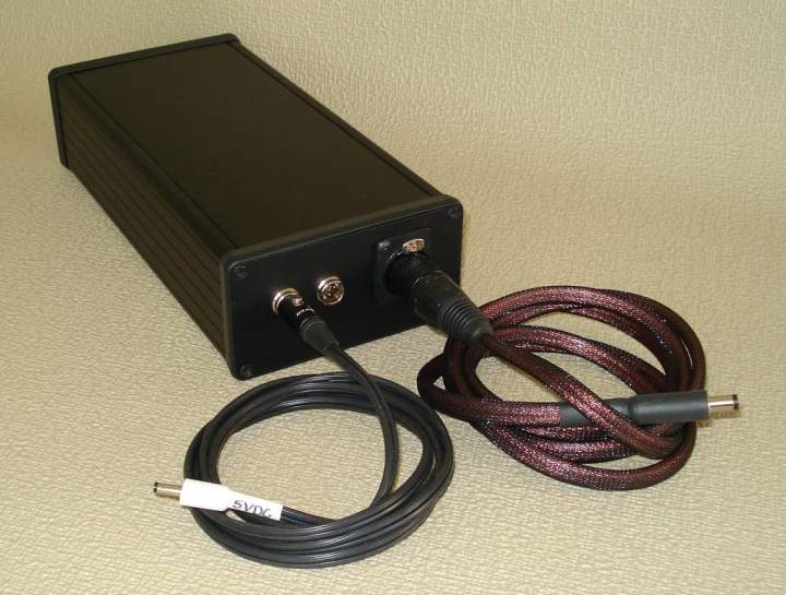

Here are the first pictures taken of the BatteryBUSS.  These are kinda quick and dirty, but will give you all an idea of what is coming.  These show the cabling that will be standard for the group buy.  The small accessory cable shown is a 5V regulated DC cable.  5VRDC is identified by the white heatshrink on the outbut connector.  12VDC outputs will be all black.  6VRDC will have gray heatshrink on the output connector. and 8VRDC will have purple heatshrink on the output connector.  Other voltages are available upon request.  Additional accessory cables will be extra  $$$.
Front panel (outputs) Shown with a Switchcraft 5.5mm X 2.5mm DC power connector (for Mac Mini DC upgrade) on the high current cable and a 3.5mm X 1.3mm connector on the accessory cable for Oyen 5VRDC HDD.
Back panel (12vdc input) The input cabling will come with additional spade lugs, medium size ring terminals and heatshrink so you can install the connectors of your choice.  The ones shown are for full size battery flag connectors.  The On/Off switch is not shown in this picture.
Let me know what you think.  Better pictures and more info is OTW.

Dave,thks for the pics, pls confirm the plum colored cable is power to the Mach2 mini.  And what is the center (unused) connector used for ?

Will you discuss at all about what's inside?  I see that the unit is in a metal case and not your typical potted MDF enclosure.

Roger, yes the large diameter cable (actually 14ga copper conductors peeking through the TechFlex) is for the Mac Mini.
All of the conductors in the TinyXLR are used.  Both of the TinyXLR chassis connectors will carry 5VRDC and 12VDC.  The output from each of these will be determined by the cable used.  I chose the 4-pin because it is highly unlikely that anyone will have a mating connector on anything they have that could be plugged into the connector - for whatever reason   :?  .  I'm trying to keep it as safe as possible given that there are no TinyXLR female chassis connectors available like I used for the standard size XLR output.

Jason, yes - to a point.
There is a noise filtration core to deal with sulfation and other noise from the battery.  A bank of electrolytic and film capacitors.  A reverse current trap to keep bad things from happening.  A circuit breaker that may end up as a manually resettable iexposed type nstead of a thermal reset unit.  Additional noise filters to prevent crosstalk in the unit between the different outputs.  A 5V regulator.  That is what I will admit to being in there.   8)

Dave, I'm looking at a battery with spade terminals, are they standardized such that yours would fit ?
dBe
  • Posts: 2181
    • PI audio group, LLC
Re: BatteryBUSS update!
« Reply #16 on: 9 May 2011, 02:31 am »
Roger, all of the ones that I have seen are 1/4" terminals and the spades that I am using are #10 X 1/4".  The input cable to the BatteryBUSS is 10ga.
When someone orders the BBUSS, I will terminate the input cable to whatever you wish and include the extra connectors and heat shrink so that they can be changed at a later date.
Same goes for the output terminations.  I can pretty much do whatever the customer wishes as far as connectors go as long as I know the size.
The Mach2 MacMini DC conversion uses a 5.5mmOD X 2.5mmID connector, BTW.

A clarification is needed on the 5VRDC out put on the BatteryBUSS.  I am using a 3A regulator that is heatsinked to the chassis.  The 1.5A rating that I have been stating is PER OUTPUT CONNECTOR if both are in use.  If only one of the TinyXLR outputs is used for 5V, then the full 3A is available at that outlet.
I may move up to a 5A unit just for the headroom.
