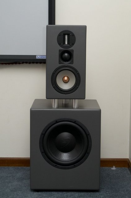

Rick, your recommendation of having the Tempesta mounted ontop of the TC/12 had me interested in seeing what this configuration may look like so after looking at the Gallery you have I found the picture linked below. I'm guessing this would be very close to what that configuration would look like.
http://www.audiocircle.com/image.php?id=18024
Was this setup was done by a customer or by Selah? It does look very nice either way.

That design you noted was built by a customer from a kit. I thought that it looked pretty cool too!
